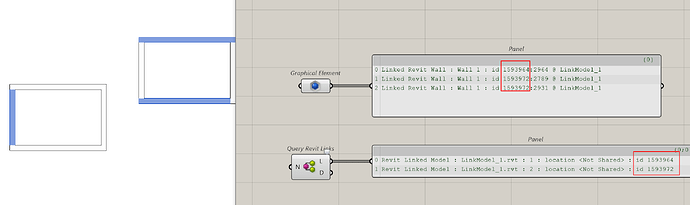

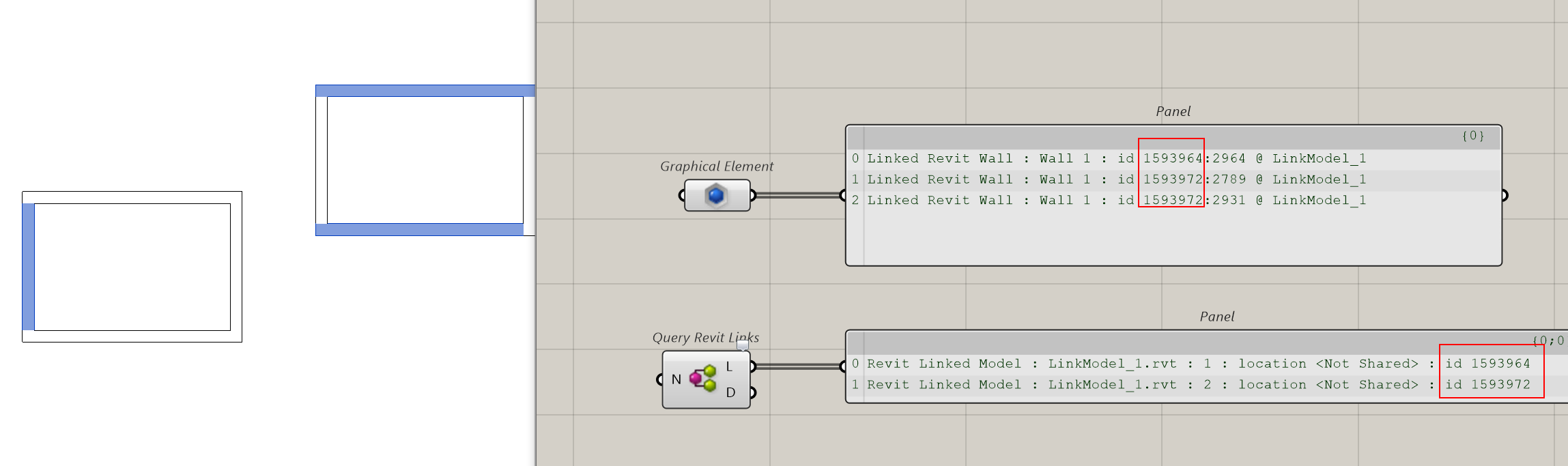

Also while working on the above, I am wondering if there is a component or a way to get which link instance an element is coming from when using graphical element to manually select using any revit/rhino versions?
The ID of the link instance is showing in the panel but don’t think I found a way to get that information using Revit components other than splitting/matching text… am I missing something?
I see what you mean, casting to the document doesn’t provide the instance ElementID, you have to get the LinkInstance

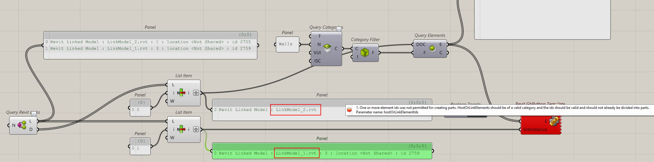

I am getting an error
  1. One or more element ids was not permitted for creating parts. HostOrLinkElements should be of a valid category and the ids should be valid and should not already be divided into parts.
    Parameter name: hostOrLinkElementIds
The Walls Are attached to roofs and my project has many phaces.
If i remove the Walls categories seems to work.
Would you be able to isolate a couple of walls that cause this error or replicate the issue in a separate model and share it to have a look if possible?
EDIT1:
I have checked and I got this error when I intentionally provided wrong input (Elements from one link document with a wrong Link instance), so maybe you can confirm your input is matched correctly.
I have also checked with attached walls and it created the parts with no errors.
EDIT2:
Updated script with the below check and cleaned it up a little, try it out and let us know
