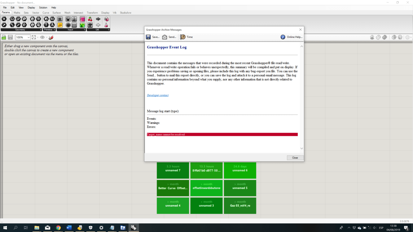

  • I try to open the file “8ffb…” and now I get this error: Target_name cannot be resolved
  • I then try to open this mysterious file created yesterday “d96b…” and i get: IO Read error: Unknown data type encountered

  • Just in case you need to know I’m using Rhinoceros Version 5 SR14 64-bit 5.14.522.8390 and Grasshopper Build 0.9.0076

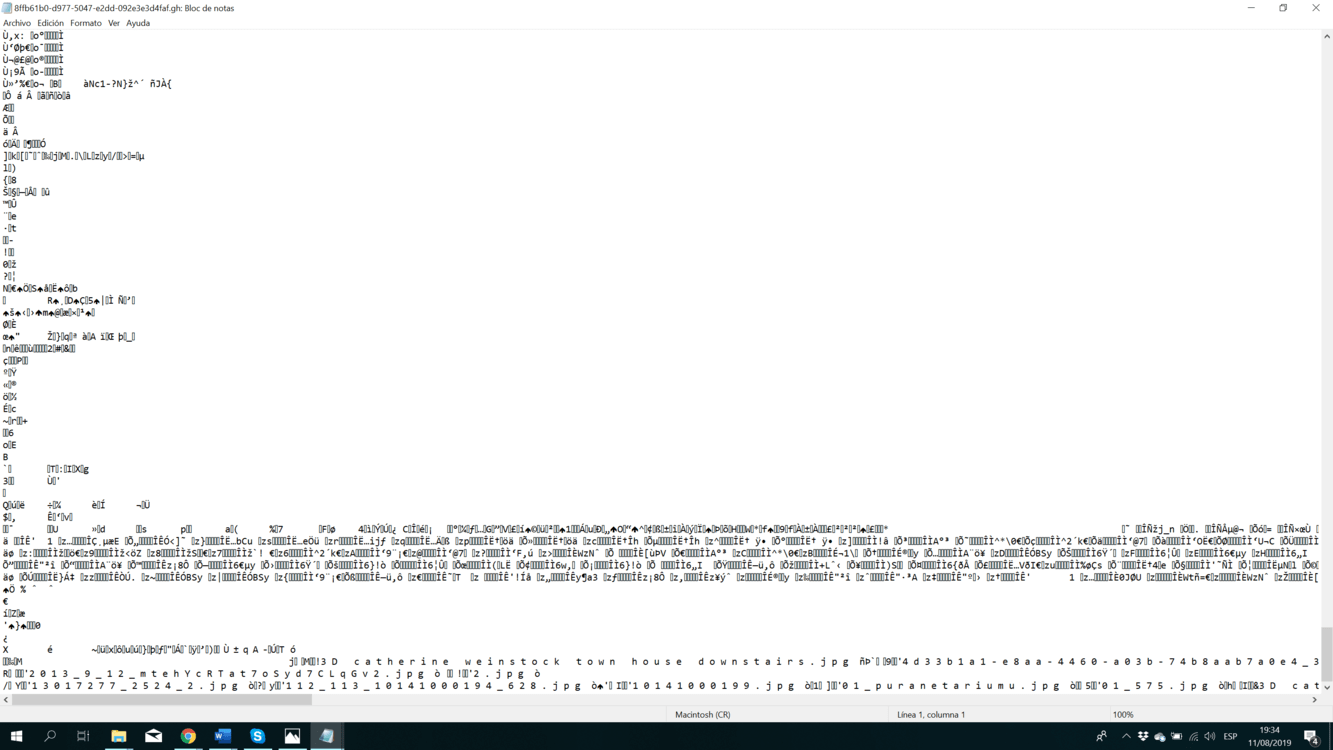

That bigger file has also been filled with text. A lot more text, don’t know where it came from:
You can open it using Notepad.exe to see for yourself.

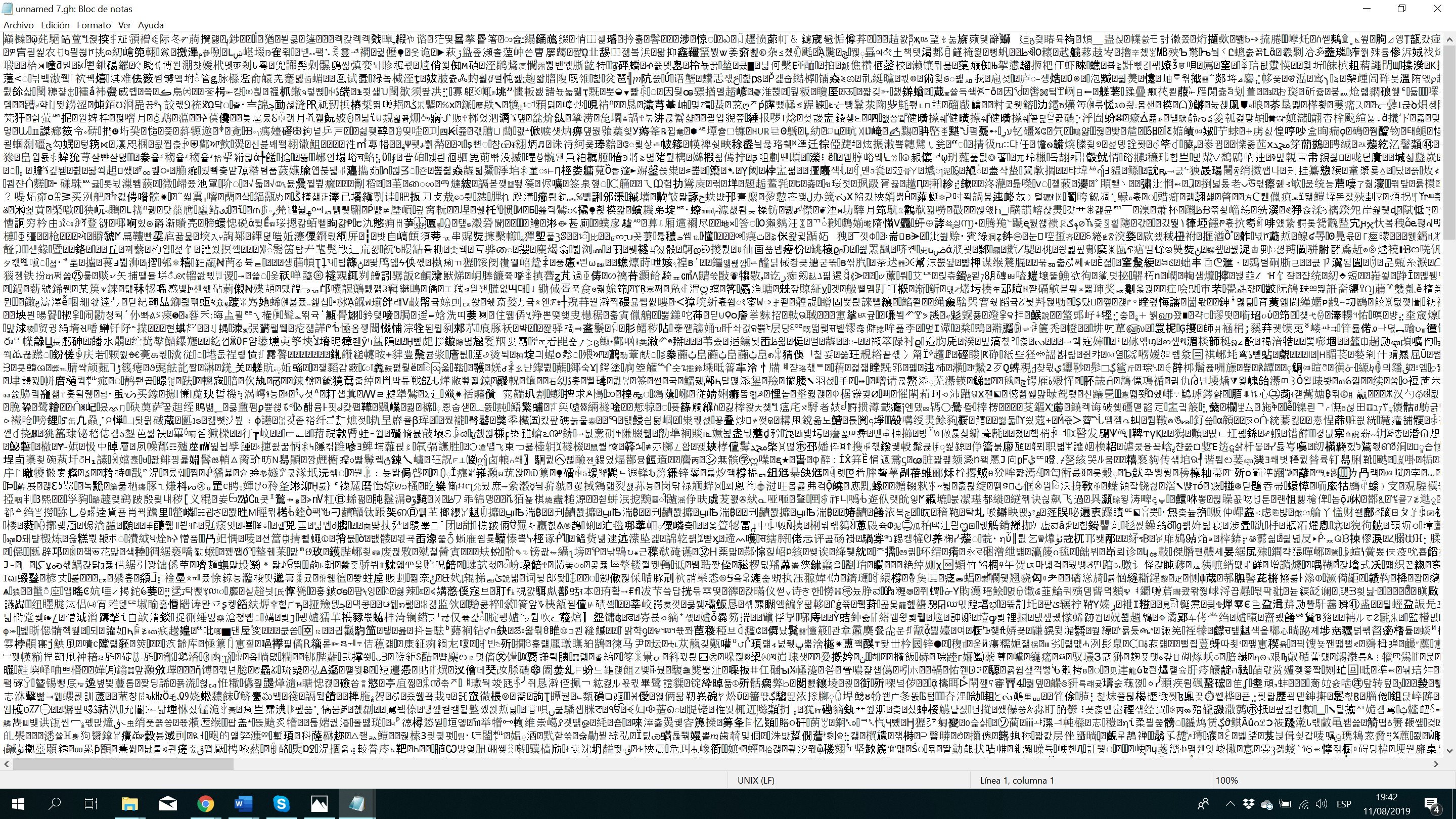

wow this is incredibly weird! I am now checking all my files with the notepad:
  • I’ve checked the file from my computer and it gives another result:
8ffb61b0-d977-5047-e2dd-092e3e3d4faf.gh (302.2 KB)
(it starts in blank and as I scroll down things appear)

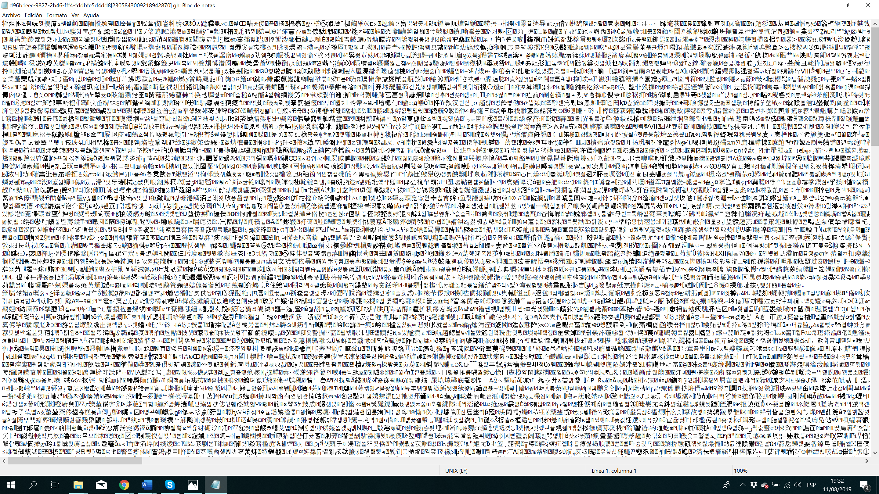

  • Also, when I open this second file that I refferenced before I also have a totally different thing:
d96b1eec-9827-2b46-fff4-fddbfe5d4dd8.gh (384 KB)
(this temp file appeared after the program closed for the last time and after the original temp file got deleted automatically)

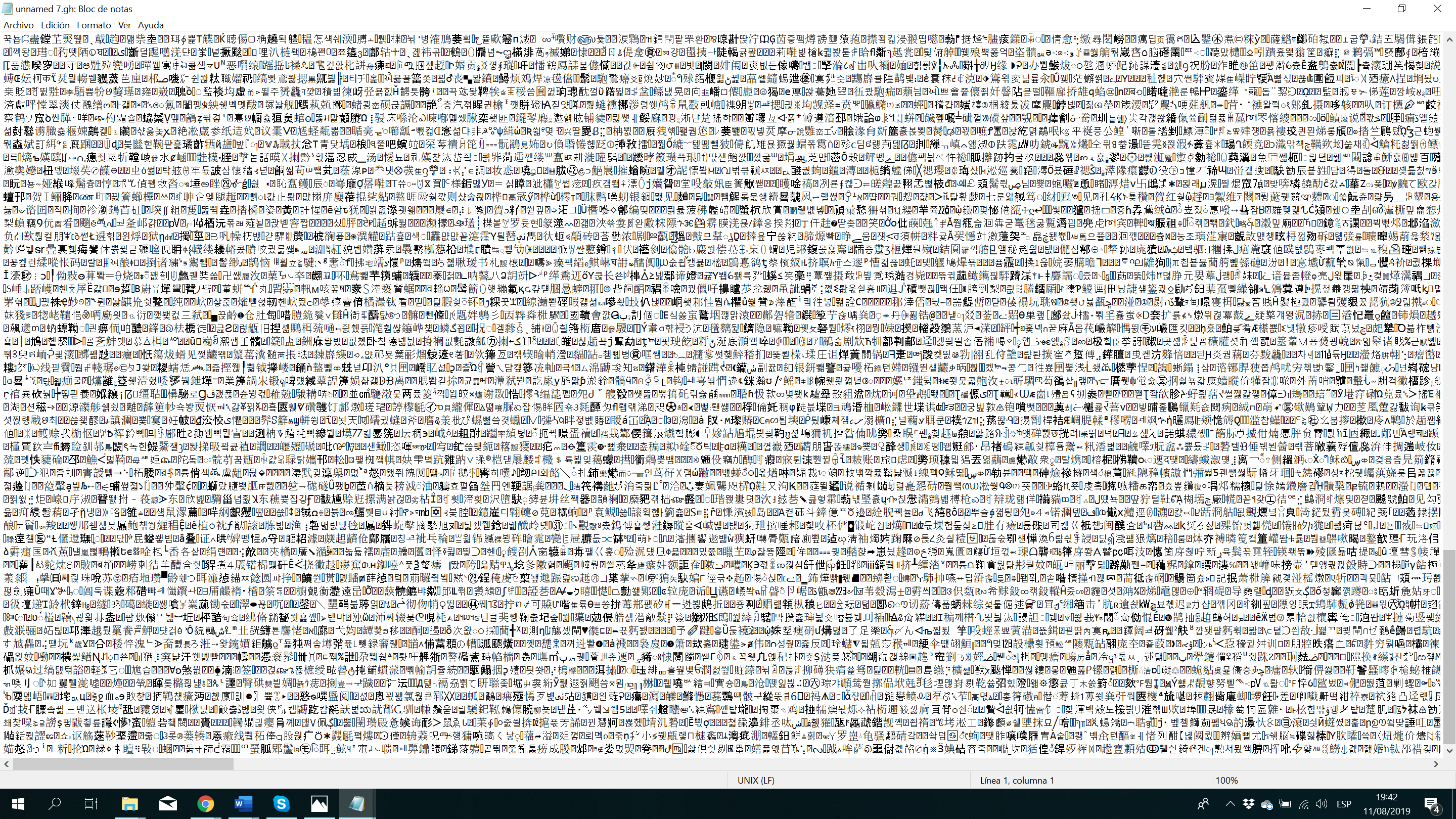

  • I noticed that this is a similar result to what I get when I open other working files, here I show you the original files from which the temp was created and from a definition that opens correctly:
By chance, could you please try to open or recover the other file I uploaded above “d96b1e…” that got created mysteriosly when all this problem happened? Maybe it is a temp backup file from the original temp backup file, this would be my last attemp to recover the file I suppose.
I put it here so you don’t have to scroll back up:
I see that the contents of the notepad from this file are very very similar to the ones from working files so this has shone a ray of hope in me and if you could try to open it I would greatly appreciate, when I try to open from rhino I got the IO Read error (I shared the screenshot above).

What you see is binary data. Binary data can be incomplete. If so, its extremely challenging to recover it, if not impossible. This is what I was speaking of at the beginning. .gh files are binary data, ghx are xml like data which can be read by humans.
The files I inspected had their contents replaced with regular text. That’s why they could be opened in notepad. If a gh file is intact (or damaged in some binary way) notepad won’t know how to read it. It’ll just assume the bits mean text, so you’ll get junk on the screen.
If a gh file is not damaged, it can be viewed using the GH_IO_FileViewer.exe (I think that’s what it’s called).
If however a gh file is damaged there’s nothing you can do. The file format uses compression so a single bit out place will ruin everything.
