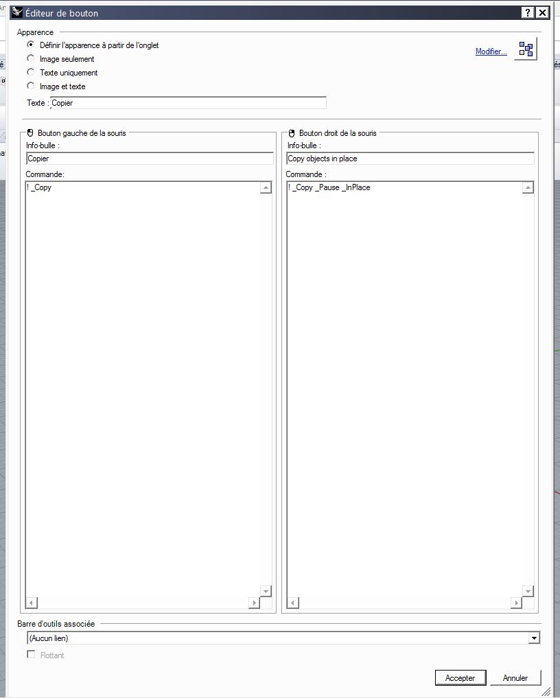

Thank you Helvetosaur for your answer, when I open
the button editor and type the command"! Copy_Pause_InPlace" in the “left mouse click” tab
it doesn’t work

You need spaces between the terms…
_Copy _Pause _InPlace

It should, despite your cracked copy of Rhino. Your last image of the command line still shows no spaces. Note also that it’s in the right mouse button box, not the left.
:thinking:
I copied exactly the line you gave me with the spaces
look:
! _Copy _Pause _InPlace
