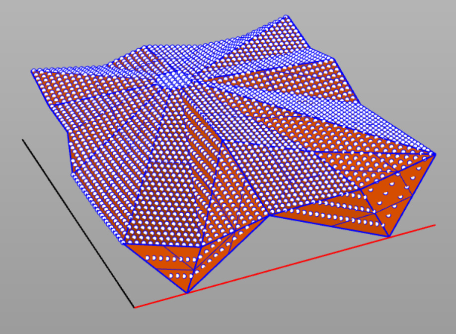

I 've made a shelter in rhino using the command “make surface from 3 to 4 points”. However now I want to put a patern on the surfaces. I create a paneling grid using the paneling tools. But every surface is separate and the pattern is not the same at all the surfaces… Is it possible that I can merge all the surfaces together? not only 2 of them…? Thus I can get a unified surface and put the pattern on?

Hello - if you are using PanelingTools, you can join the faces and create a grid from say. two lines -
Is that something like what you’re shooting for?

Yes I believe that it is really close to what I am trying to do! The next step is to add the 3D pattern in, and hopefully the result will be ok.

I understand what your point, I want to create a roof structure. I imagine that if I create one smooth surface without any kink, or crease, that the problem of connecting them together wont exist… It is more important to apply the pattern without changing it , thus to change the surfaces into one new. Rather than changing the pattern so I can keep the surfaces intact.
Do you want to apply the pattern at the element’s current size, or will it be scaled down? Because it is currently large in relation to the likely curvature of your revised surface I think you will struggle to get a solution without distorting the elements significantly.
