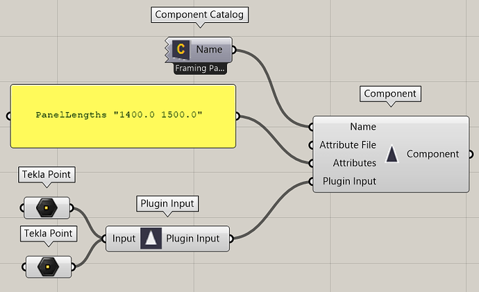

Those contextual toolbar icons seem to be for the Framing Tools extension. Whatever you modify using those buttons will be stored as attributes for the Framing Panel component in Tekla. This means you’d need to set the appropriate attributes when inserting the component from Grasshopper to achieve the same result you’d get by using the contextual toolbar in Tekla.
E.g. like this for the panel lengths:
You can check the available attributes by referencing the component into Grasshopper and using the “Deconstruct Component” component, like this:
Note that if you add an opening to the frame in Tekla using the contextual toolbar, that results in an additional component being inserted - the “Panel Opening” component. This component can also be added from Grasshopper.

Sorry for the late reply. To elaborate on what I said earlier, the contextual toolbar commands are a shortcut for modifying certain attribute values for the Framing Panel. Like the spacing of the studs. Normally you could also modify these values through the component dialog. In either case, the values are then saved to the Framing Panel component as attributes. You can use the “Deconstruct Component” component to try and find out the underlying attribute names.
Here you can see the same values being propagated from the UI to the dialog and the underlying attributes when you e.g. change the stud spacing from the contextual toolbar:
So, in this case, to set the spacing from GH, use the attribute “Spacing” followed by a string of distances like this:
When you add an opening through the contextual toolbar it will actually insert another component, the Panel Opening component. To do this from Grasshopper, you would add the Panel Opening component using the Framing Panel component and two points as an input:

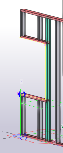

Hi, after playing around with this a bit more it seems there are strange things happening under the hood with the framing plugins.
Apparently the input points don’t really matter as long as they aren’t identical, they will be recalculated anyway. Instead, the opening location as measured from the origin of the frame is determined by the WindowOff attribute, and the width of the opening by the OpeningWidth attribute.
For the vertical location of the opening, the attributes are SillHeight and OpeningHeight.
Note that you might need to trigger the “Component” component twice after opening insertion to get the opening to update properly, the first time it might be a bit off from the location you’d expect it to be.
Note 2: To investigate the available attributes and see how they change if you move the opening manually, you can reference in an already inserted opening from the Tekla model and use the “Deconstruct Component” component to browse the attributes:
This is how I found the above attributes and noticed how the input points get recalculated.

The distance attributes are float type, so you’d need to add a decimal point:
Otherwise they are treated as integers. This is subtle I know, but that’s how it works.
With the “Construct UDA” component you can change the type using the Type input (right-click the input to see the options).
