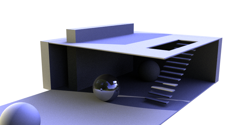

Sometimes - very often - I need to do some “clay render” (that’s how some people call it on the forums!).
In V4 I just can’t do it. In fact, I’d love if someone could help me on it.
However, in V5 there’s the Skylight option in the Render settings, which seems to do the work.
See the sample below, just to know what I’m talking about (done in V5):
In this image, there’s no darker shadows, which is great for my goal. (If there’s a way to do it in V4, please tell me how)
But there’s a problem: I need to render the wireframes along with the image, however, it looks terrible when they are on it. See the image below:
In a Rendered viewport, the isocurves appears normal (thin).
Why they look so thick in the final render ?

Try to render at higher resolutions; the lines will be less thick in relation.
In V4 setup a box with area lights around the object to get the skylight effect.

What about the ‘old school’ trick of making two separate images and merging them in PhotoShop? Here’s how I would do it, with extra steps to make sure the render view and captured view match exactly.
1: Adjust your viewport size and save it with Named View
2: Render the gray forms using the viewport’s aspect ratio, but make it whatever resolution needed
3. Switch viewport to shaded, make background white, and -viewcapturetofile with a matching resolution.
4. Open both images in photoshop, put the capture on top of the render layer, and use multiply layer mode.

Willem, sorry to tell you this, but I’ve tried the same light scheme you have sent me…Unfortunately it look nothing as Skylight.
Here are my three images. In photoshop, I used a layer transfer called Color Burn at 50% opacity to keep the isocuves but eliminate the shading.

• ExtractIsocurve-> Extract All in U&V directions… (if you want isoCurves visible… otherwise skip this step if you just want surfaces edges & curves to show)
• make a display mode based off Technical then turn off shading…
• use -ViewCaptureToFile with 5x the size of your render (that said, i have to do it that big on mac because no AA is applied with the viewCapture command (bug?)… exporting way bigger then scaling it back down after will smooth out the lines…
• use Transparent Background in the export dialog…
• those last two steps will let you get only the lines visible to camera with everything else transparent:
• resize the big viewCapture then lay it over the render…

You can turn on skylight in Rhino 5.
And here I added a simple white to black gradient to the Environment:
As you can see Rhinorender and Neon handles the gradient differently.
And here I used a HDRI with a multiplier of 3 (to make it lighter) and sat Neon to have a white background instead of the Envrionment image.
