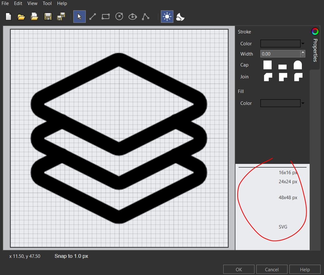

Another thing I’m noticing is that svgs won’t render in the toolbar if they’re larger than 48px x 48px. Given that there are many open source svg sources to download online and many sizes, I guess it might be worth making that clear somewhere in the docs that svgs should be max 48px x 48 px. Or handle replacing the width and height svg attribute values automatically in the editor upon loading. Having this new ability to customize icons via svg attributes is fantastic. Thanks!
Can you give me an example of an SVG like that? Are you importing them into the SVG Editor or adding manually to an RUI?

This was happening when loading them into the SVG editor:
The SVG renders correctly at multiple scales in svgviewer.dev

Changing the width height attributes to max 48px works:
 width="48px" height="48px"
Yep. I see this. It’s supposed to strip out the height/width so it defaults to 100% x 100%.
Good find @bfrederick, thanks for this, fixing this will prevent some other bugs too!
YT : https://mcneel.myjetbrains.com/youtrack/issue/RH-86126/SVG-does-not-have-a-preview
RH-86126 is fixed in Rhino 8 Service Release 18 Release Candidate
