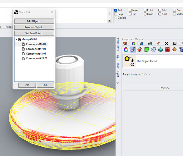

Hello- you need to set all components to have material ‘by parent’ This is done, tedioulsly, in BlockEdit but I thik I have a script someplace that will do the lot at once.
Would you be able to give me a quick rundown on how to do the by parent edit with “BlockEdit”
I am just seeing Add Object, Remove Object and Set Base Point.
Hello- - highlight one of the objects in the list - component#6 01 say. Now Ctrl-A in the viewport to select everything and in Properties> Material page, set the material assignment to ‘Use Object’s Parent’
