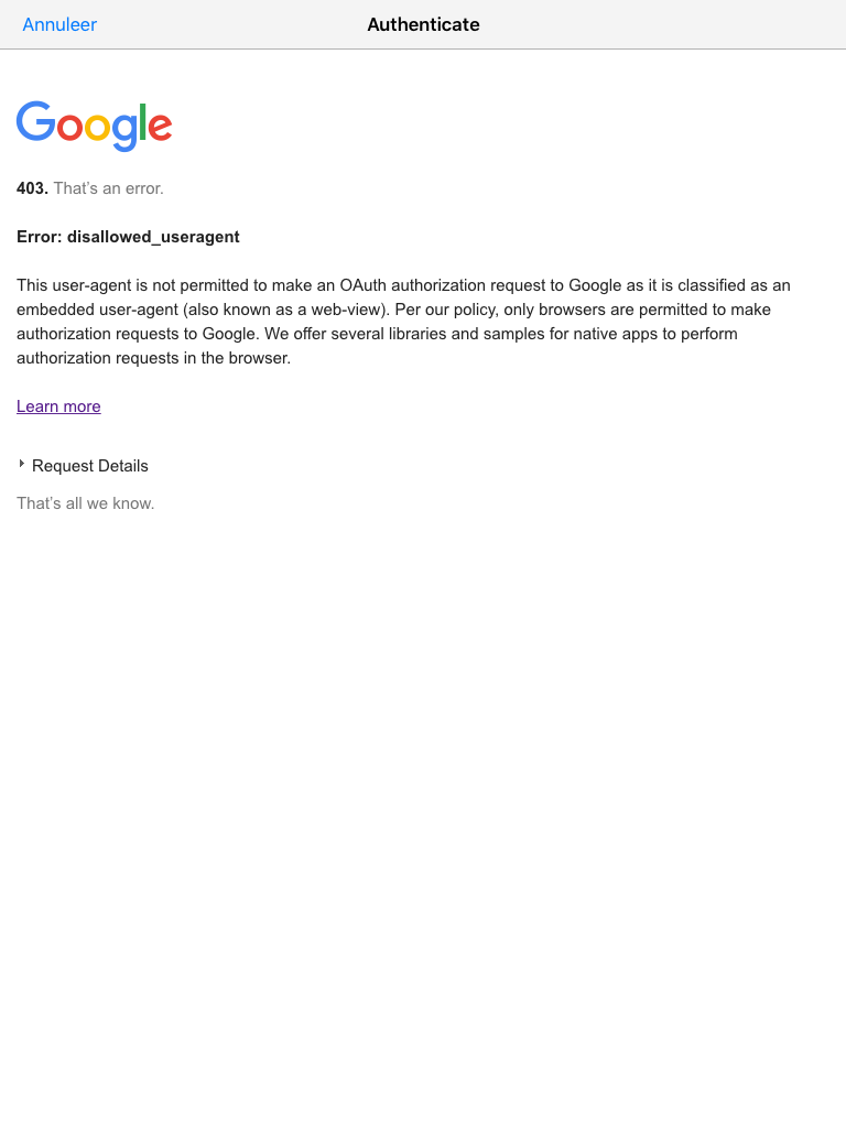

I have the same issue, dropbox gives no file or folder at all, when I try to log in on googledrive I get a message
  1. That’s an error.
Error: disallowed_useragent
This user-agent is not permitted to make an OAuth authorization request to Google as it is classified as an embedded user-agent (also known as a web-view). Per our policy, only browsers are permitted to make authorization requests to Google. We offer several libraries and samples for native apps to perform authorization requests in the browser.

Do you think McNeel will be able to solve this problem? Its frustrating because I count on being able to show my 3D work to customers on the go, from my iphone or iPad. I have this problem on my iPhone 5 and iPad 2. Both Dropbox and GoogleDrive fails to work. After signing in Dropbox doesn’t show any files at all. Google gives me a notification.
The “Learn more” sais this, which is quite unreadable for me:

Hi Henk-
I remember this issue well (it was a surprisingly onerous fix; presuming it is fixed, that is).
Google authentication was having this problem about 2 versions of iRhino 3D ago and I fixed this issue (Dropbox had no such restriction).
I cannot reproduce it on my iPhone or iPad, I’m afraid. Have you updated to iRhino 3D 2.2.2?
-Dan
Ah Henk, I think I know what is going on here. You likely cannot update to 2.2.2 because your devices do not support it. I’m afraid we cannot support these older devices anymore as much as we would like to.
The message is from Google, but Dropbox doesnt work aswell, I see no files or folders at all when I log in. I am not able to upgrade to a newer version, perhaps because I have an older type iPhone (5). The iPad
Yeah, see my above comment. Unfortunately, we can’t support the older non-64 bit devices anymore and the timing of the fix for the 403 issue was unfortunate to say the least. I’m sorry this has broken for you. Despite that patch fix, improving cloud-service syncing is a big priority for me going forward (with what little time I get to spend on iRhino 3D).

I think I know why. I’m working with Google to resolve this issue. They have presented quite a few (in my opinion unnecessary) hoops to jump through. I’ve done the first two (created Google Drive sensitive scopes list and proved we own rhino3d.com), but now they want us to submit a YouTube video showing how we use Google Drive. Sigh.
UPDATE: I’ve submitted the video Google requested, so :crossed_fingers: they reauthorize our app.
Just to be clear: this is 100% on Google, not us. They added these rules without much notice and didn’t give a clear picture of how to jump through the hoops. It’s seriously annoying for a developer.

It should be working again now. Thanks Google.
