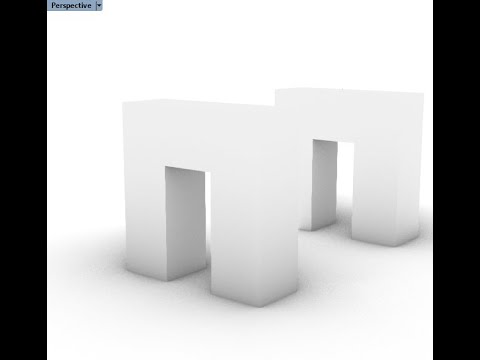

Hi
Rhino Gumbal have feature Snappy Gumbal.
Do we have this feature when use Clayoo Gumbal?
Reference video:

From your video I think the snappy option is not doing what you think. Check this video:
2020-07-10 09-01-56
If your purpose is to extrude a face of Clayoo, you can use either the hotkey for Extrude command or clicking ALT+move gumball as it is explained here http://help.tdmsolutions.com/clayoo/2.5/en/Clayoo.html?ClayExtrude.html

Hi @mpcarlos87
I watch your screenshot. Because It’s a line and gumball is located in center.
If you relocate gumball, you can get other result:

They have yellow arrow is normal direction. I think it is great idea.
But Everytime I use active clayoo they will automatic turn off Rhino Gumball.
Yes, If you want to work with Clayoo Gumball and Rhino Gumball I recommend you to turn on/off Clayoo depending on what you want. I don’t recommend using both when Clayoo is on.
