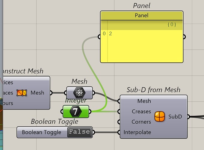

Is there a way to deform my SubD Object with crease edge?
Actually, the Grasshopper plugin uncrease it and I need to crease edges manually after bake.
thanks

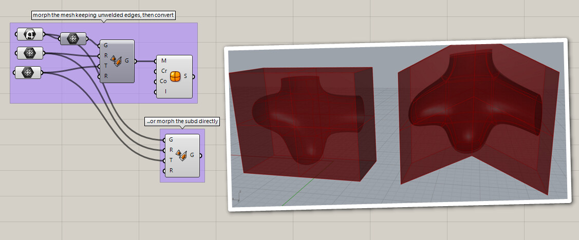

Hi @Pierrafee
Sorry I didn’t see this sooner. Yes, using the modified version posted here
you can keep subd creases and unwelded mesh edges when morphing. here’s an example
morphdemo2.gh (10.8 KB)
Thanks a lot! I did not notice this newer version of MeshCageMorph.
I will experiment with this updated component.
Extracting the control mesh of the SubD, morphing that mesh and reconstructing the mesh is not neccesary anymore to keep the creases I see.

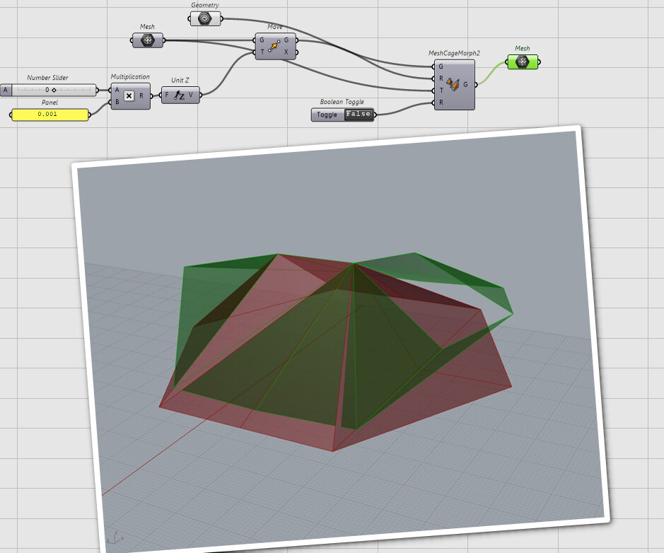

Not sure I’m doing it right…
Here’s another simple example of the MeshCageMorph2 component with just a curve.
meshcagemorph2.3dm (57.8 KB)
meshcagemorph2.gh (17.1 KB)
