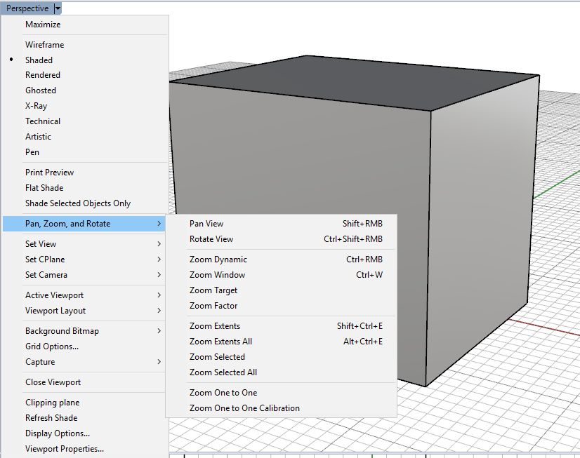

Is there some portion of your course that tells students to hold down ctrl+shift? Just curious
No. I don’t tell them, Rhino tells them! Its directly integrated into the interface. See examples below.
Any further updates? If you Mcneel guys are considering this as a potential future fix, hey, let me know.
Hi Dave - no, no updates that I know of. As far as I can see the behavior is pretty straightforward and predictable. Ctrl-Shift-RMB rotates a view, period-if you don’t want to rotate the view, don’t do that… right? . The ‘Always Pan’ setting applies to the RMB-drag. It seems to me changing this behavior would be a horrible breakage of perfectly reasonable behavior.
