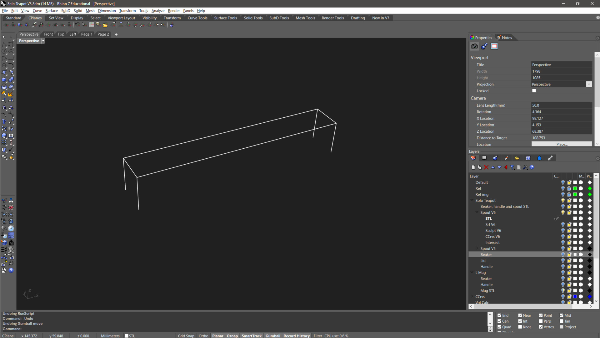

I have an automatic altitude ground plane on in my shaded view and these bounding box curves get cut-off. When I turn off the ground plane, the curves get shown again:
The bounding box is sitting on z=-5.218 and if I set a point at z=0, it’s level with the cut-off line so it seems like automatic altitude doesn’t take into account curves?
Object selected:
