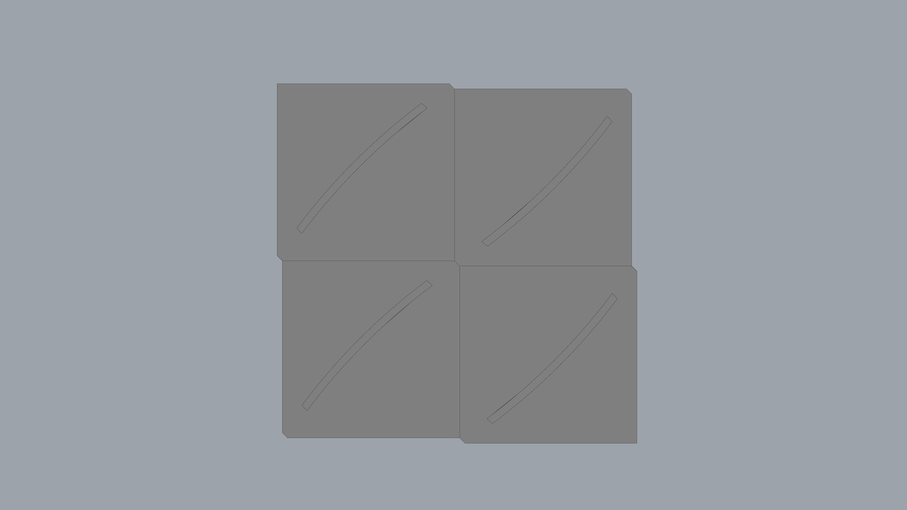

I’m trying to use Box Morph to project a pattern, which doesn’t have a square boundary, onto a curved surface so the corners of the pattern fit together. Is this possible or if I’m using the incorrect method?
I’d like to gradually reduce the height and fade out the pattern toward the edges of the curved surface. Is this something that can be done using Box Morph too?

I got something fittinh - I hope - your description, using Sporph.
The problem I see here with Box Morph is that your input’s contour is not a rectangle, so you will always end up with a gap between repetitions. The array, although “rectangular”, does not follow the world axis.
I chose to not cover the entire surface, but you could also rotate your pattern slightly to fit closer to the surface edge - a scaling is still needed and left as an exercise to the reader :smiley:
For the height reduction, I calculated the distance from the center of the pattern to the surface edge, but there are obviously other possibilities (mapping from UV coordinates, with a math equation or with Graph Mapper…). For the record, it could be done with Box Morph, by moving more or less the upper corners of your target box.

If I want to rotate the input pattern by 45 degrees so it’s in a diamond formation instead is this something that I can do in the definition? I’ve tried rotating the physical pattern in Rhino and didn’t get the desired result (Please see my attempt in the image below).

For the diamond rotation, I culled one pattern every two. The global rotation of 45 degrees is still needed, then reposition the base surface on it.
It is also possible to rotate the pattern, but in this case you have to modify the calculation of the repetition vectors in “X” and “Y” directions. Your pattern does not follow an orthogonal array, which actually is a problem for the repetition around the bowl, I can’t get the patterns to be perfectly aligned.
