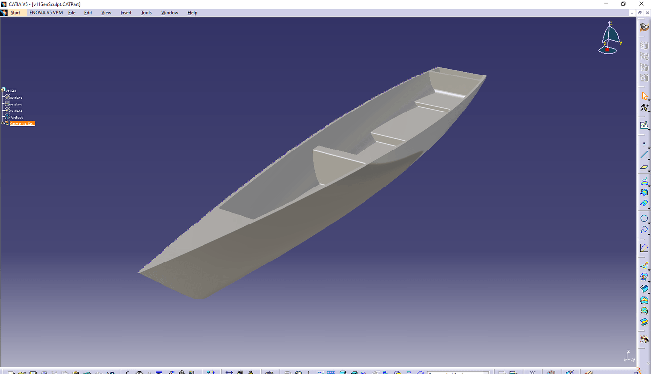

hello! i was actually able to achieve desired result! check out! @davidcockey hello! nice samples you got but i always prefer whats easy to edit and manipulate. low cv count and cubic deg for easy shaping and relatively smooth surfacing… anyways interesting models!

@davidcockey hi yes but for my boat design i prefer having less control point. 6 x 6 cv is too much for me… i was able to build such hull!! she’ll perform beautifully in tank test. she’ll be 3d printed… thankyou so much. have a look!
