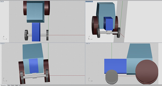

Best method cplane to front while keeping views same?
Looked at this further, and instead of trying to set up these CPlanes by using rotations of existing CPlanes it’s much easier to do it using the 3 Point option of the _CPlane command.
I will use the Perspective viewport to set-up and save all the CPlanes and then apply them to the other views.

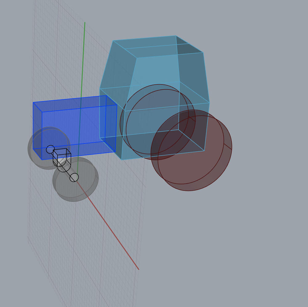

Now the CPlane in the the Perspective viewport should have it’s origin at the center of the front wheel, it’s X-Axis should be oriented towards the front of the wheel, and it’s Y-axis should be oriented towards the top of the wheel as shown here:
Note: I’m using an X-Ray display mode here with increased transparency to be able to better visualize the CPlane axis indicators.
This CPlane matches the orientation in the Perspective viewport in your “desired outcome” screenshot, so save it in the Named CPlanes panel with the name F-L_Wheel_Persp-View.

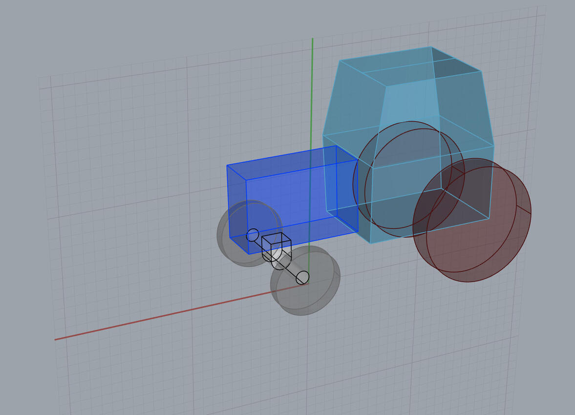

The Perspective Viewport should now look like this:
Don’t worry if your result doesn’t match this the first time. You can restore the previous CPlane by double-clicking the saved CPlane named F-L_Wheel_Persp-view in the Named CPlanes panel and then try again.
When your view matches the picture above, save it with the name F-L_Wheel_Top-View in the Named CPlanes panel.

Now you can activate the saved CPlanes by dragging them from the Named CPlanes panel and dropping them in the corresponding viewports (or you can double-click each of the names of the custom CPlanes in the Saved CPlanes panel while the corresponding viewport is active).
You should also run the _Plan command while each of the Top, Front, and Right viewports are active to insure the views are aligned with the newly activated CPlanes.
The end result showing all viewports should look like this:
