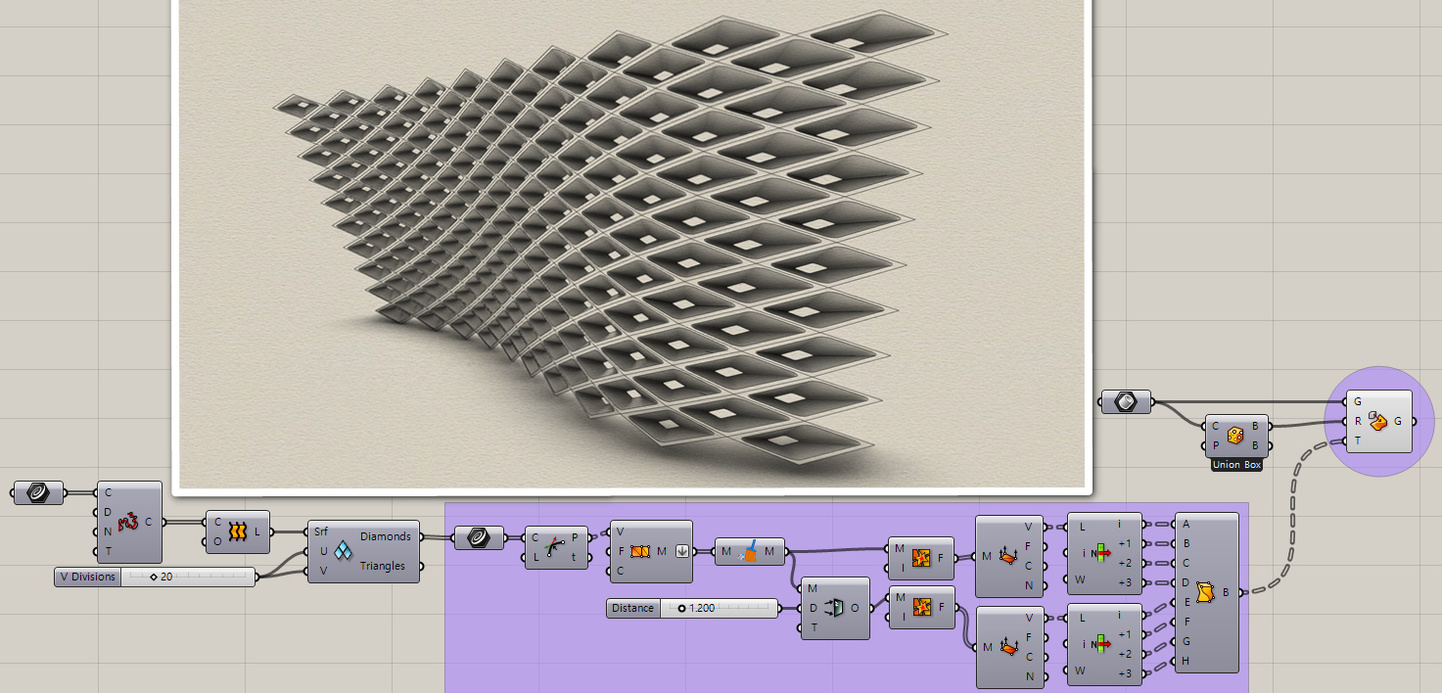

I used surface morph and lunchbox to adjust a reference shape on a given surface but some gaps are created between the transformed geometries. I can understand the way that happens but I have no idea how it is possible to be solved!
I would appreciate any help or advise!

Try this way instead.
MeshTwistedBoxMorph.gh (19.4 KB)

You can also use Paneling tools
Surface morph_pan.gh (17.6 KB)
Unroll the facade. Make the panels on the unrolled facade (so they have continuity across the seam). Split the panels at the seam. Morph each flat facade faces panels to its corresponding actual facade face. Make a planar surface from the seam rotated half way between the two facade faces that share the edge. Trim each facade faces panels at the corner with that planar surface.

Anyway, check the attached example. If you can prepare one single untrimmed surface for base geometry, then you can make corner panels at the same time.
MeshTwistedBoxMorph_re.gh (35.3 KB)

Nice idea to use unsplit surfaces, here is my version with Pufferfish.
CornerMorph_Pf.gh (13.7 KB)
