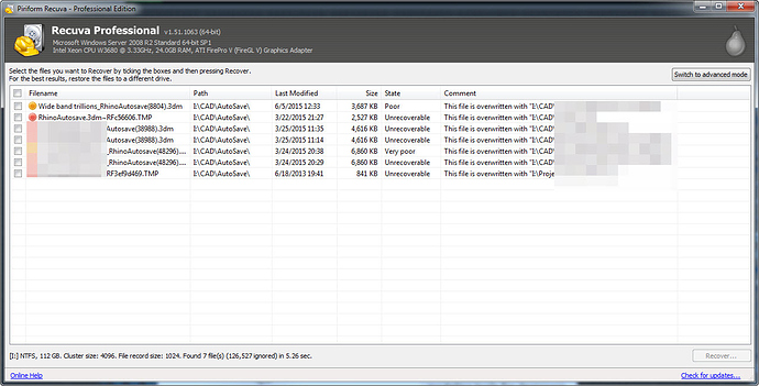

I have autosave set to every 5 minutes and have worked on 20 models since April 28th. Where are my recent autosaves? I why do i have older useless ones but not the new ones that could save me 6 hours of work?
The current RhinoAutosave.3dm is for a different model. I scrolled up in my command window and saw the autosave for the other model (I:\CAD\AutoSave\Wide band trillions_RhinoAutosave(8804).3dm
), but it’s missing. So I used Recuva to see if I could bring it back from the dead:
Nope, it was immediately overwritten. The recovered file was too corrupt for Rhino to recognize. This is my version of Rhino:
This is the worst possible time to learn this about autosave…

Oh, snap. My I:\ drive is set up with Google Drive. The deleted autosave file was in the trash bin of the cloud. Whew…
