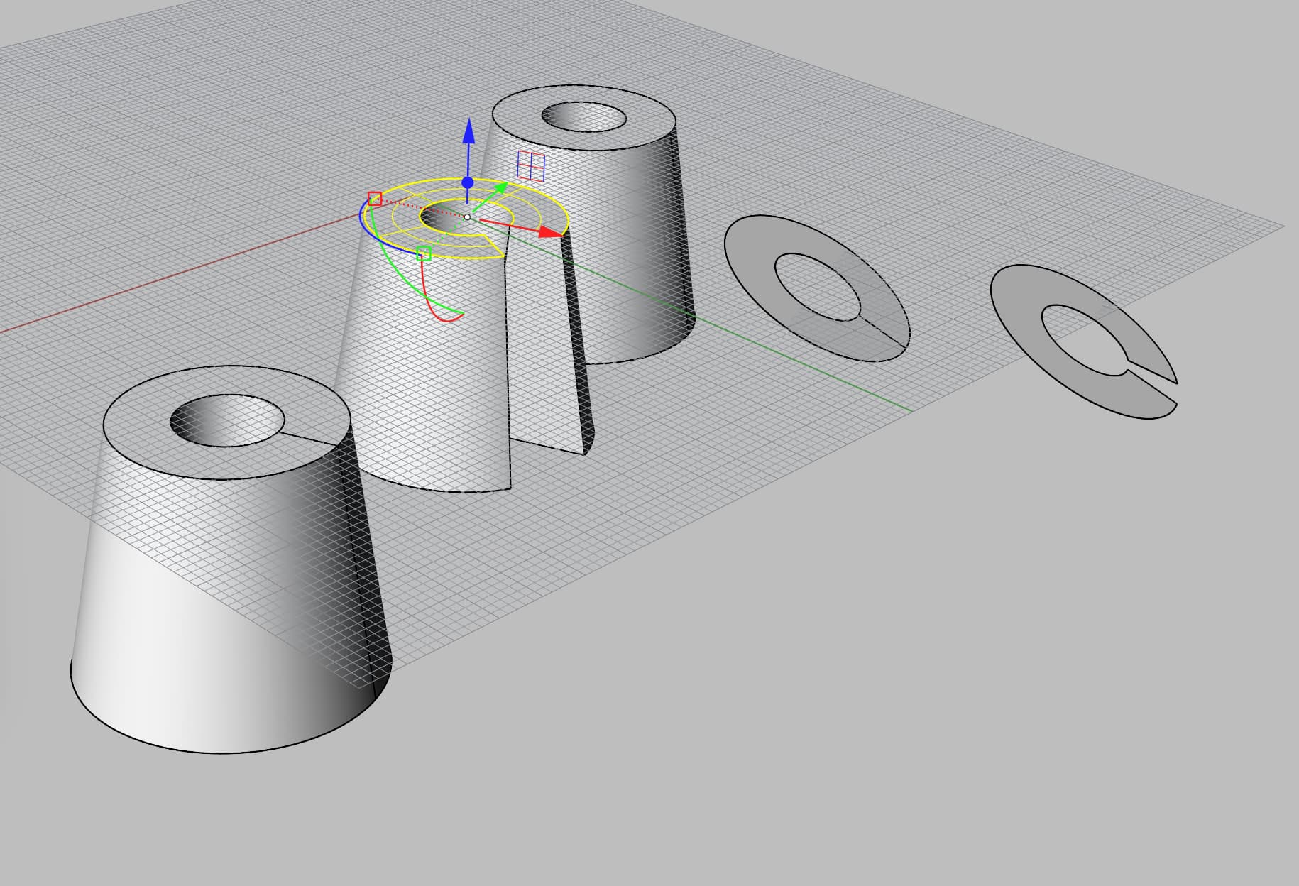

I can’t seem to get auto c-plane to attach to a circular surface that has been made from a revolved sketch, which has segments?
see image 1 below

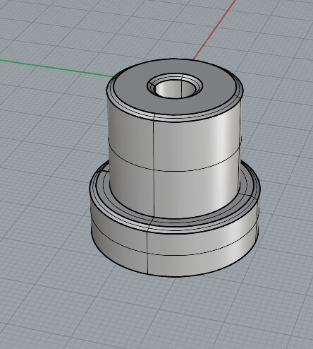

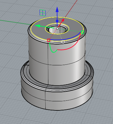

but if I delete the surface and create a new one from the two curves it creates a single clean surface, and the auto cplane works with it?
see image 2 & 3 below

AutoCPlane snaps to a revolved surface unless it’s revolved a full revolution.
I think it’s a bug
AutoCPlane_revolved-surface_problem.3dm (167.6 KB)
Yes this is a bug. The Auto CPlane doesn’t align to surfaces with seams. In this case it should because the face is planar. I opened a bug here.

thankyou, in the short term is there a quick command or way to change a surface like this into something that can be snapped to?
or is it just a case of deleting it and remaking the surface?
Hi Adrian -
In the short term, it’s a case of remaking those, yes. In many cases, you can use the Cap command to replace such surface after the revolved version has been deleted.
