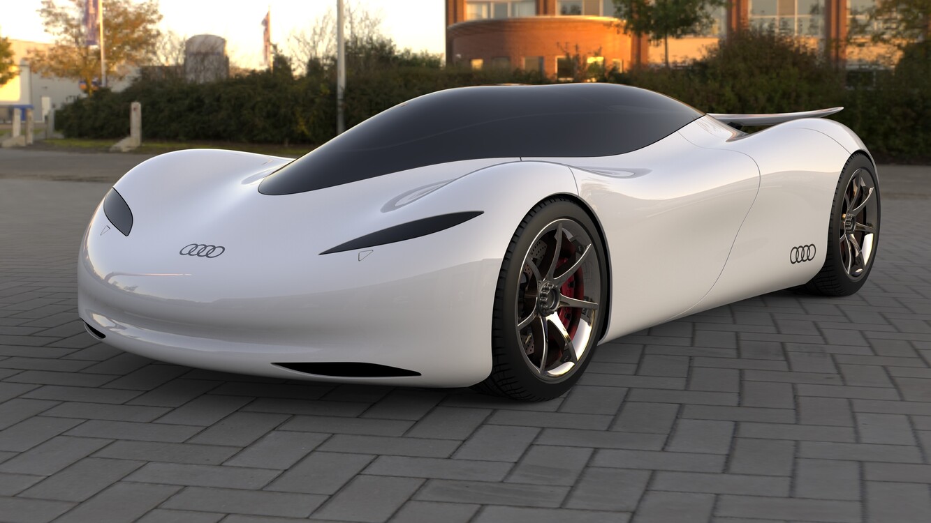

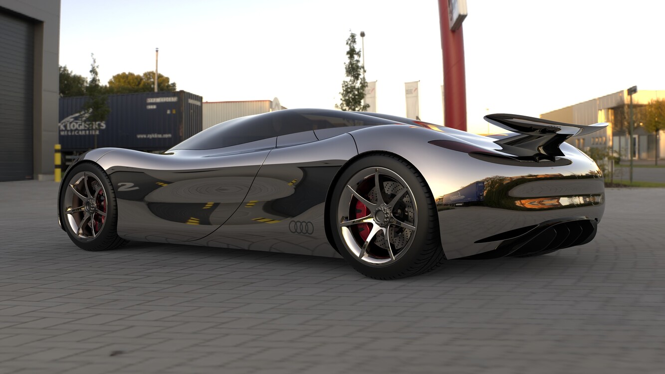

This is a 3-seater sports car that I originally designed back in 1999 in 2d and as a small half gipsum scale model.
Recently, I wanted to test the capabilities of the new SubD modeling tools in Rhino 7, so I decided to create something organic that would otherwise take to long time to create with the usual NURBS tools. Not to mention the time required to modify the shape according to my taste. With SubD, editing the shape is extremely quick, because it uses Catmull-Clark geometry.
I used to call my design Audi R9 SS at the time, but now I changed its name to Audi Avus Zwei, as a tribute to the famous 1991 Audi Avus Quattro prototype used to showcase Audi’s advanced aluminum technology that the company pioneered in the early 90’s.
However, for my design I choose a few different material finishes instead of aluminum, such like titanium and copper. Optionally, the rocker panels could be painted in white, silver or any other colour in a similar fashion as the distinctive coloured side panels of Audi R8.
I added a rear diffuser and underbody deflectors around the wheels. The rear bumper also has a slightly more optimized shape.
Shining Brilliant~ :heart:
Love the smooth surface!
white and metal one looks really nice.
Thank you for the kind words, guys! I appreciate your opinion!
@Toshiaki_Takano , when I do car design I always use the panel gaps as a design feature and try to make them flow across the body shape in a specific way to enhance the looks. This particular concept has the bare minimum of body panels and does not rely on sharp crease lines typically used on the majority of cars as an easy way to give them more character, this is why its overall look highly depends on how the panel gaps are arranged. If they are done right and have an interesting shape, the car could greatly benefit from having different colour on the rocker panels.
lovely concept and history depiction. for my taste a little bit too bubbly, if the roundings could be maybe a bit more filigree and accentuated. love the white patch render, gives it some audi feeling. generally the high gloss is too heavy bling bling imho :smiley:
If things get right, I would love to develop this particular sports car with a normal roof and proper door windows based on my current project. This is why I created the Audi Avus Zwei using the same wheels, wheelbase, height etc. :slight_smile:

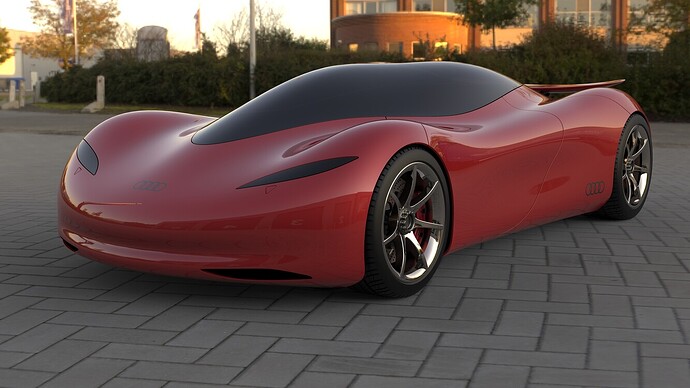

Here is it painted in white and red. Due to the minimalistic bio design and a total absence of crease lines, the car does not have the same visual impact like the version with reflective coating and looks too bland by the modern standards. Adding a front license plate will help a bit.

Render engine used?
Keyshot, maybe? :thinking:
I’m curious… :wink:
Yes, Keyshot 8 HD from 2018. For my basic needs it’s not worth to upgrade to the new Keyshot 10 and I will probably use it for many years to come. :slight_smile: I also use an old PC* from 2014 and don’t consider buying a modern one, because Rhino 7’s viewport rendering is very responsive with the car scenes I create and throwing more money will not help me work faster.
