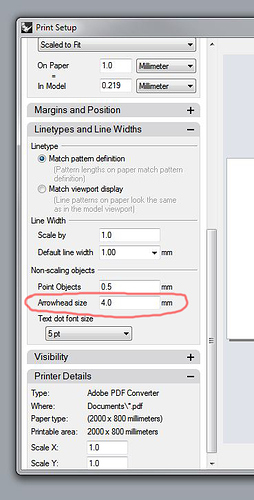

When you print it in pdf. control + p. You will have the chance to change the size of the arrowhead.
Hope this is useful.
