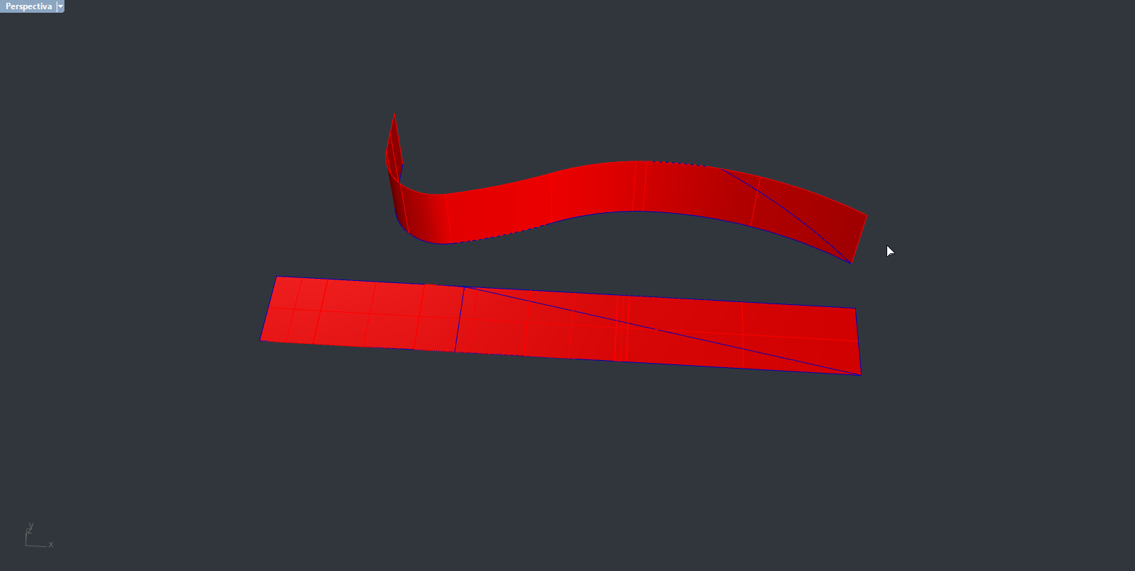

First sorry for my bad english, im not native so i try to be especific with my trouble.
I need to model a curved ramp so, ir order to get it i have the path and the height to reach.
Then i unrolled the surface to “apply crv” to it, but the command just read one trimed surface not the full one
So the question is: how can i apply the slope to the full surface?
Hello - use UnrollSrfUV here.
Actually a better workflow is
  • UnrollSrfUV
  • Add your curve
  • CreateUVCrv from the flattened surface and the ramp curves
  • ApplyCrv the result to the 3d surface, including the bounding rectangle.
