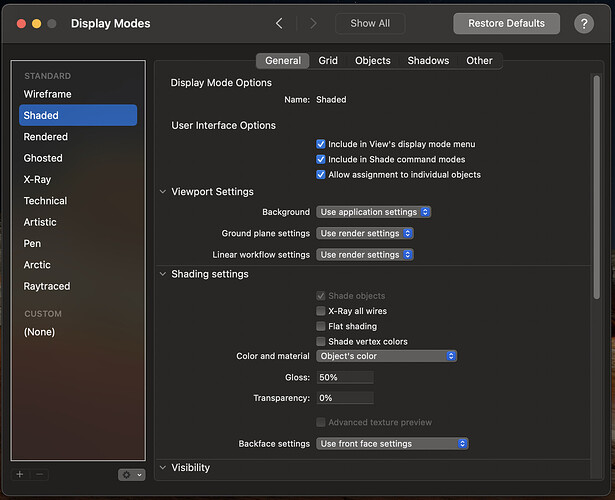

thanks Jacopo, i am still left unclear to what exactly you have changed. only custom display modes? meaning all others work? and in case you managed to figure it out, what was it in the custom display modes that gave your mac a hick up?

I just remembered I posted it in this thread a while back
https://discourse.mcneel.com/t/apple-silicon-m1-no-for-now/111987/65?u=jacopo.cavagnoli
anyway… it crashed whenever I tried to activate a visual style that involves showing “custom materials” or if I tried to open the material section of the “properties” panel.
Wireframe mode worked just fine but when I switched to “shaded” it crashed when trying to display a 3d object. The other display modes as well…
To make it work I changed the “custom material” setting that was on by default in the “display modes” to “object’s color” settings for every view that was crashing. Plus I just steer away from the “material” properties panel like it’s Mordor.
Rhino works for me but I only do 3d modeling (and I am a student so i have EDU license for FREE :slight_smile: it’s important to understand my point of view haha)… Renders / Texturing etc are done in keyshot. I don’t know your exact workflow so I wouldn’t encourage running on unsupported HW but I can confirm that it’s possible to make it run with the 3d modeling functionalities intact. just forget rendering with rhino for a while, or at least until it’s fixed.

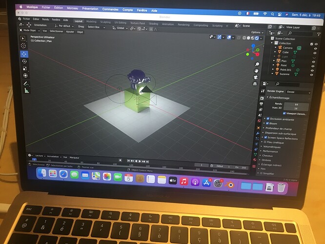

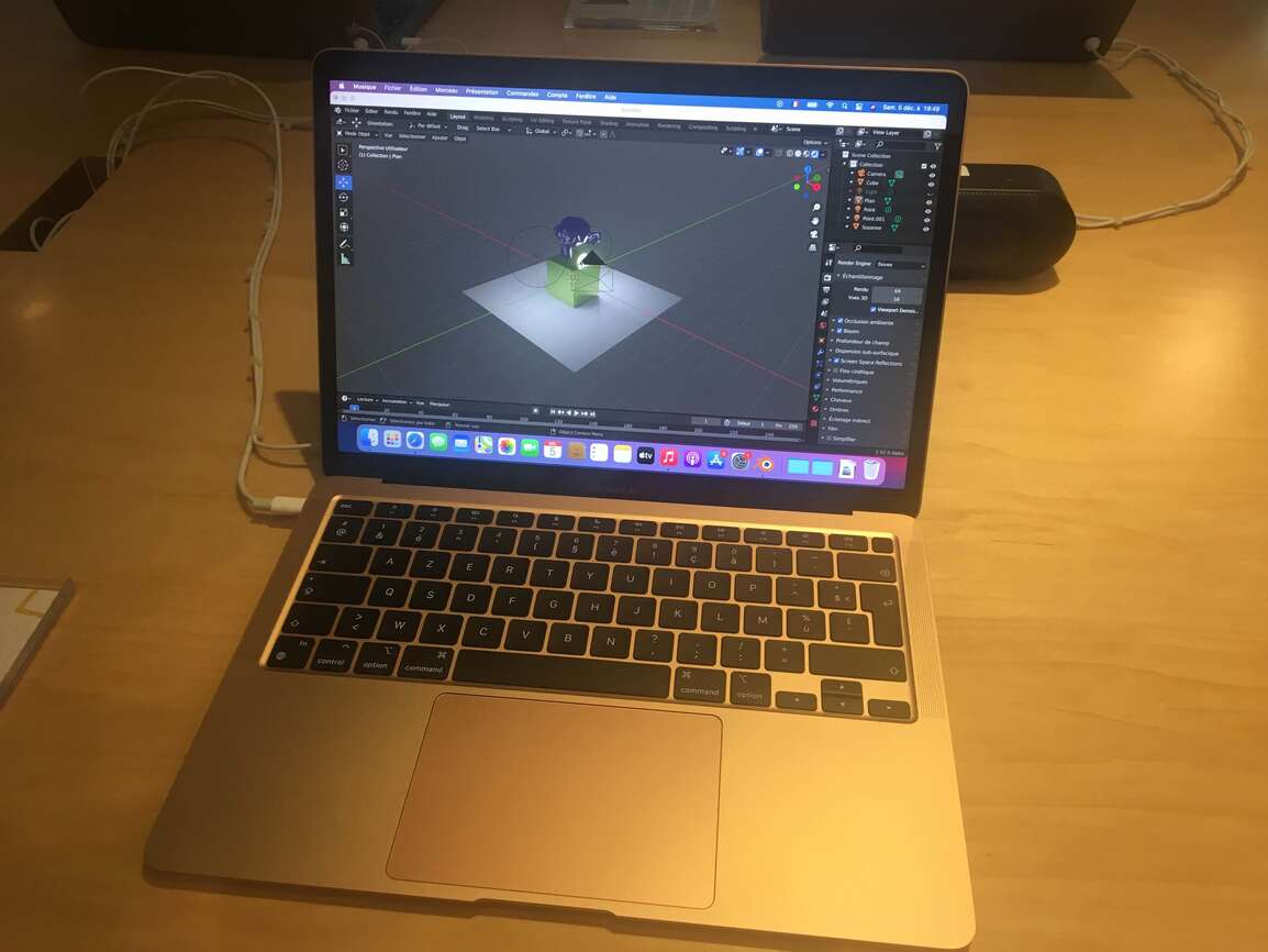

Yes I play maybe 20 minutes with a dowloaded Alpha version of Blender (under development) that do not crash at any time.
I worked only with EEVEE and everything was very fluid. I use array to copy a scene x1000, then x4000 and more than 10 000 times with a blue glossy suzan on a gold cube, a light, some volumes. Fluid !
Days after I copy and paste manually thousands of time a simple scene with lights (thousand of lights) !
The MacBook Air M1 was the cheapest version with 7 GPU cores instead of 8…
Fast, fast, fast…
I don’t know if Blender work perfectly on M1 (I see some good feedbacks). If it is the case, maybe McNeel must have a partnership with Blender for the transition (maybe it is the case for Cycle ?).
I made snapshot with my iPhone :
