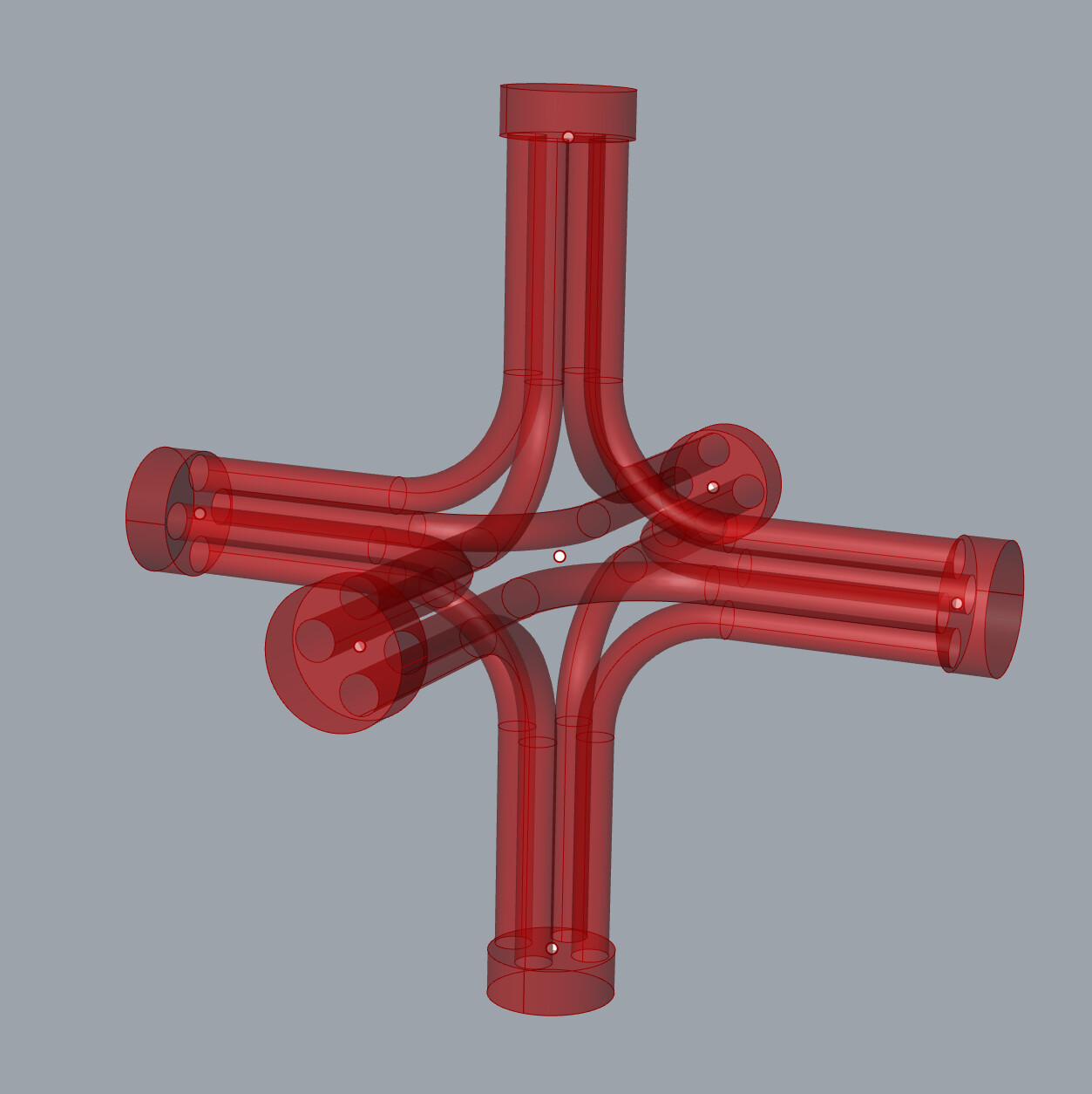

hi all im trying to make this kinda shape using this tuts
https://www.youtube.com/watch?v=ETWWx88iXec. well the question is how do i make instead of vertical, it goes in horizontal so that it fit to this frame and have xyz customable size
weird pipes edit.gh (31.5 KB)
box tapi gagal.gh (13.6 KB) also I have a problem with the file weird pipes. i tried to duplicate it like that photo with number series but the parametric become too heavy and not responding i need another alternative for duplicating object that more simple. can someone spot my mistake and give a feedback?
the module should be connected with each other. I tried to add different panel for each module but it wont change a bit. i just don’t know what to do please help

In your definition, the cross shaped object has duplicate curve segments.
It should have 12 x 90° angles and six discs.
What’s the idea with this?
It’s a tower, I want the shape but rotated 90 degrees so that it fit to my frame structure. And I want to add xyz length, wide, and height parameters to the cube module, so the shape is more custom-able.

I fixed the object in the orange group.

I think you had other topics where you looked for help how to create this main shape.
Your definition would be more flexible if it was based on a box and when you change the size of the box, everything is adjusted downstream.
In my example, the discs are still missing but you get the point.
