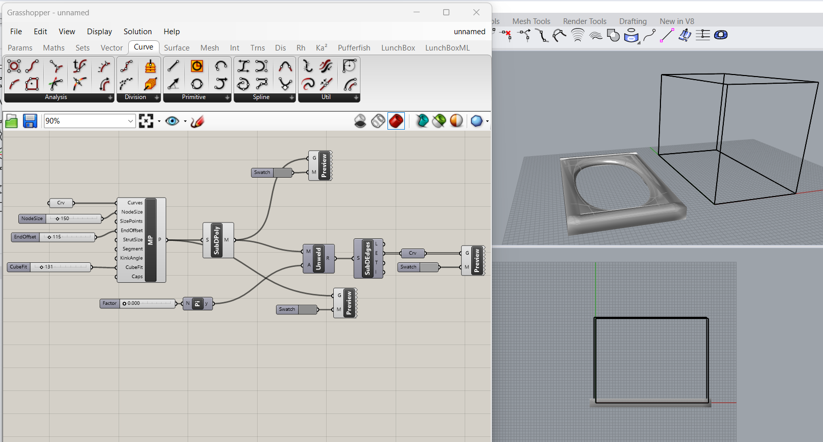

Hi all can someone teach me how to make this kind of shape? and and point what is wrong with my grasshopper parameter. I tried to used multipipe but it ended up looking like this. It should have 3d dimension shape like a frame structure.
please helppp.3dm (100.5 KB)
you have attached a Rhino file containing two cubes and a rectangle curve… no gh file .___.

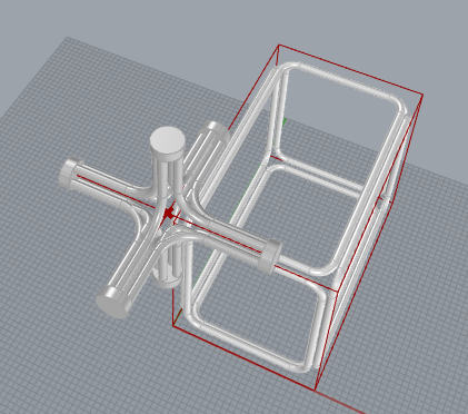

something like this could be a starting point, I would use Pipe instead of Multipipe:
weird_pipes.gh (13.4 KB)
the above resembles the look of the pipes running along the frames, but if you want to mimic also the composition method used in the picture, I think the base module is more this (dirty sketch):
weird_pipes_base_module.gh (21.3 KB)
This is one whole piece Multiple, you only need to crease certain edges.
sorry for reply it so late. first of all thankyou so much for the help. I wanna ask again if that okay :pensive_face:, do you know how to make all of that pipes have different length parameter I tried to copy the line and the panel inserting different number for the length but it won’t work, also do you know how to populate the modul like this (i just copy paste the modul sooo wroonggg)
weird pipes edit.gh (31.1 KB)
