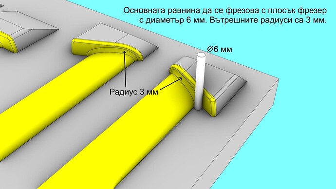

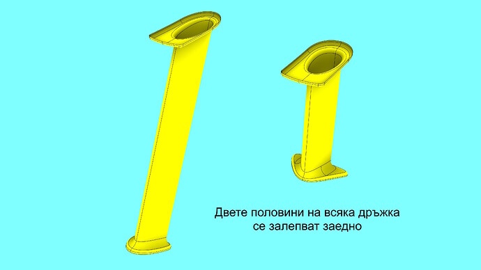

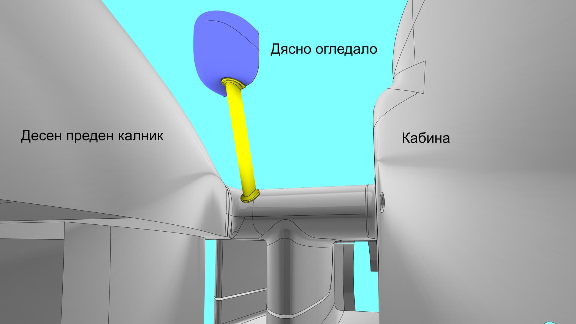

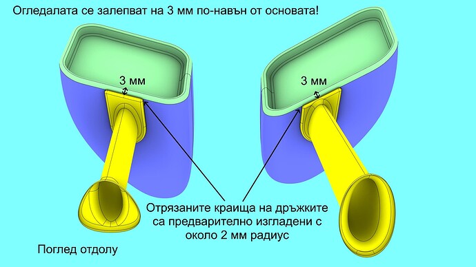

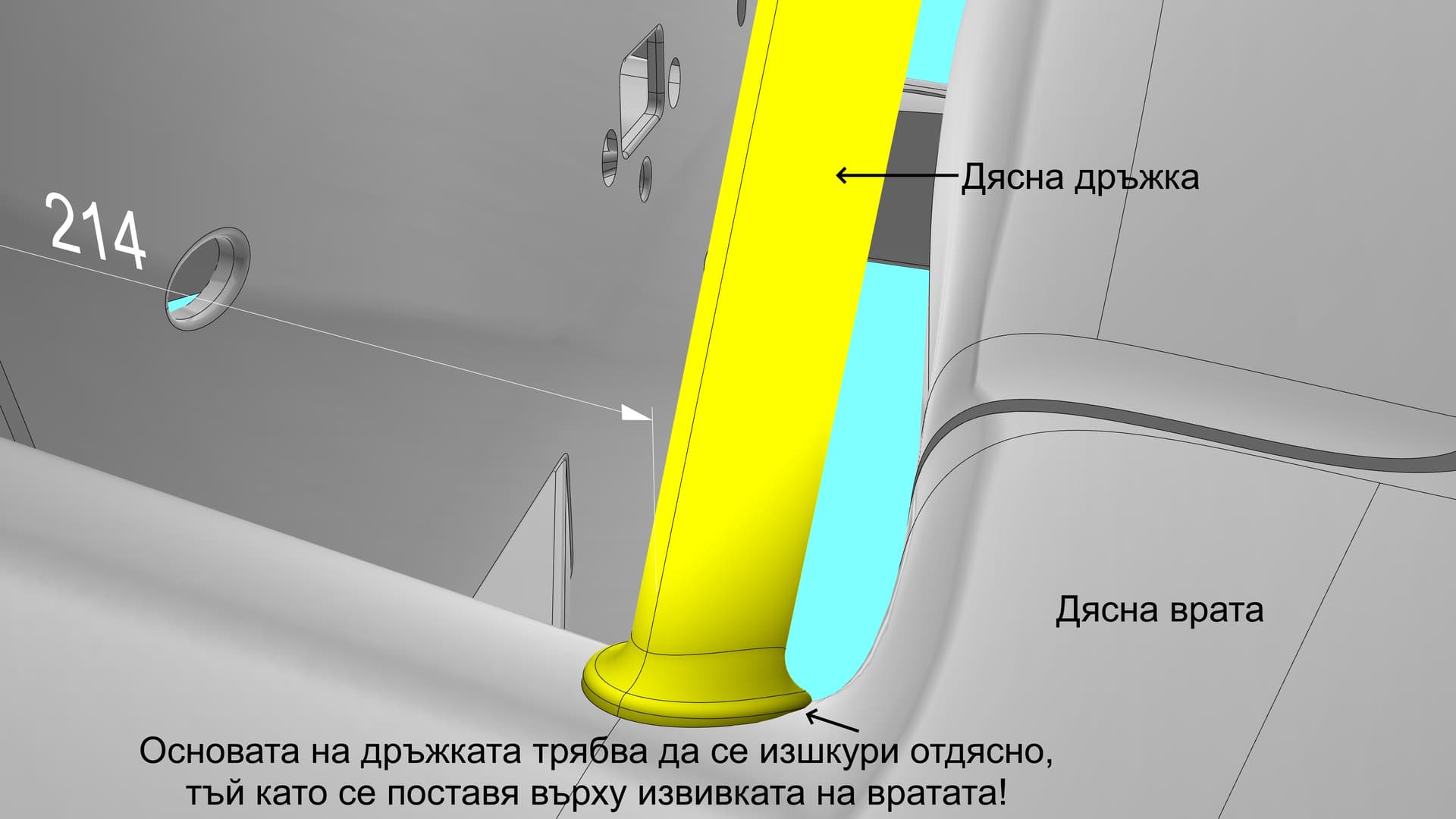

The side mirrors are ready since months, but I totally forgot to post updates here. :slight_smile: I used various photos and a couple of videos as a reference to make them as accurate as possible.
The CNC-milling, subsequent trimming and assembly required lots of steps:
Some photos of the final product. The round tip of the side mirrors was supposed to be like a ball shape, but the person who was in charge with grinding the foam plugs removed more material than necessary, hence the tips are a bit flat now…

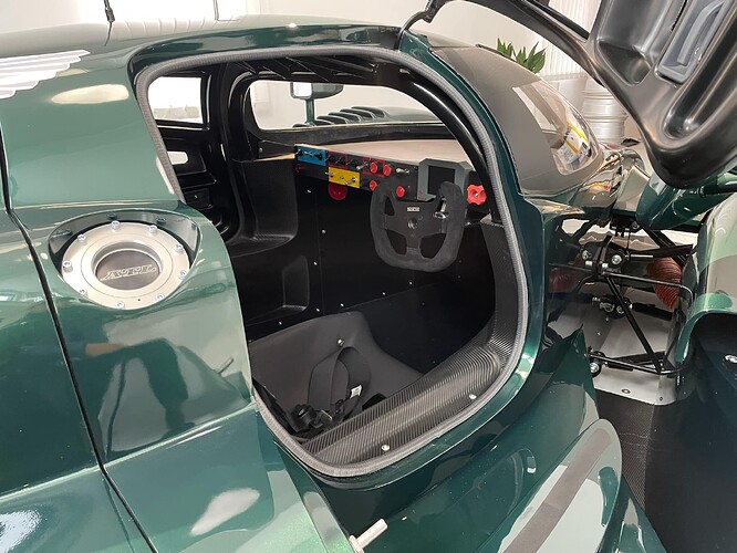

The custom made bell housing (previously shown in the topic) was also manufactured and is currently installed on the demo car:
