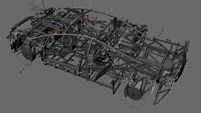

This is a new limited production Finnish electric supercar which is nearly ready for the market now. The car was originally designed and built to utilize a V-8 petrol engine, however, a few year ago a decision was made to develop an alternative electric drivetrain powered by high-density batteries, so the majority of the rear half of the chassis was altered to accommodate the new components there.

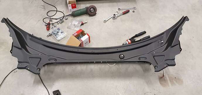

New CNC-milled aluminum uprights, A-arms, door hinges and other smaller custom components were also designed in the recent years to further optimize the weight and performance of the car. The car uses plenty of 3d printed parts, which are purposely designed to break in a small-speed car crash to reduce or fully eliminate the damage of the connected carbon-fibre body panels. Last summer the regular door gas springs were replaced with powerful hydraulic units activated via a remote control.
The NURBS modeling of the exterior was done in Rhino 5 back in 2014. Since then the development of the door jams and internal mounting panels behind the exterior (also known as “body-in-white”), chassis, suspension and lots of mechanical components took me a few extra years. Some of the later parts since 2018 were made in Rhino 6, and currently I use the new Rhino 7 for the design of the last remaining components such like window actuators, latches and a few others.

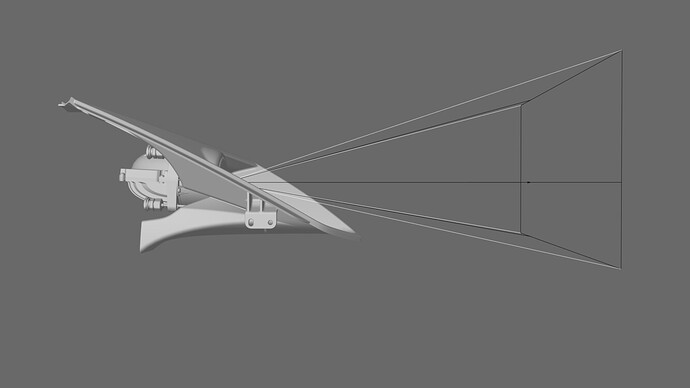

All the government tests on the car are made right now and I don’t take part of them, as I already moved back to my country Bulgaria and work from home - just like most people use to do since the pandemic.
Due to some changes in recent years, the requirements to validate a car as a road legal vehicle are much more strict now and that forced us to change the design of the headlights and tail lights. The headlight projectors had to be raised a bit and moved more forward and towards the center of the car, because the original design with clear headlights covers didn’t met the new requirements by couple of degrees. The headlight projector must be seen diagonally from a 3/4 view at specific angle, for safety reasons if there is another vehicle coming from the left or right side.
Also, the old projector was about one centimeter lower than the requirement, so I raised it as much as possible. However, that caused the removal of the clear headlight covers and using a 3d printed housing surrounding the exposed projector, because there was no free space left for the cover. The latter had to be changed with a new unit specifically designed for exposed use (i.e. without a separate cover). There are many older cars with lower headlight projectors, because they were manufactured in less restrictive periods.
The new headlight projector only had a single function as a low beam (unlike the old unit that combined both, high bean and low beam), so I ended up with the decision to use two extra high beam projectors behind the front grille.
The positive thing about that was the ability to use the free space below the raised headlight projector to add an integrated air intake to feed the front brakes with some extra fresh air.
It’s this sort of unexpected changes that take a lot of time for modifications, but the law was changed during the development and we had to follow the new rules. There are very strict rules for the seat belts, too. And visibility from the driver’s position. Things that were allowed before are no longer possible for OEM cars. In the future any new car must be equipped with side air bags, too.

The prototype car shown on the photos above was assembled and disassembled countless times, and used to have a V-8 engine in the past and currently has electric motors and 7 high-density batteries. That concept proved to be quite user-friendly for maintenance and offers a quick access to the internal components. The car is designed from scratch and is not based on an existing platform. Every major component is being upgraded to make the car better. The production cars will have thinner and lighter hand laid carbon-fibre prepreg body panels, replacing the carbon-fibre with epoxy resin on the prototype. Currently, new electric motors and batteries are installed that will offer even better range and performance. The electric drivetrain allowed us to find enough space above the batteries for a secondary trunk to store two bags with golf sticks. That was a customer request that was a bit challenging and seemed impossible initially, but luckily after some re-arrangement of the batteries and electronics inside the the space was just enough to also include a rear trunk despite the low body of the car. Electric batteries offer a lot of freedom in that regard.
The team is quite small but everyone is passionate and devoted in what they do. Currently, other people work on the car now on welding, assembly, painting, carbon-fibre work, tuning the software, sound system, electrical system wiring, leather upholstery and some other aspects of the car. I only did the 3d design and engineering of the car and tooling prior the physical assembly.
