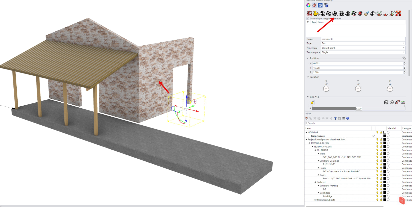

Here is some context for why I’m trying to do this, I’m using Speckle to load geometry sent from Revit as we design in Revit and Rhino but render only from Rhino. Every time Speckle loads geometry, it wipes the texture mappings from all the objects, so we want to be able to save them first, load Speckle, then restore mappings.
RestoreTextureMappings
Can you share some geometry with textures?
Absolutely, I’ve included 2 files, one with the mappings applied to meshes and blocks (Example_with_mappings.3dm) and then the other after a Speckle reload where the mappings have been cleared (Example_after_Speckle_no_mappings.3dm).
For additional context we do most of the mapping with “Apply box mapping” but we do have some cases where we use planar, cylinder or surface.
Examples.zip (13.9 MB)
I was just curious whether the mapping type could be retrieved with Grasshopper:
Weird that it does not show the surface mapping type on the 3x8 beam which isn’t vertical.
That might be correct, in Rhino it shows Surface mapping even when there is no mapping applied to the object and I didn’t apply any mapping to that block.
Are we able to save those mappings to file and then reapply them?
