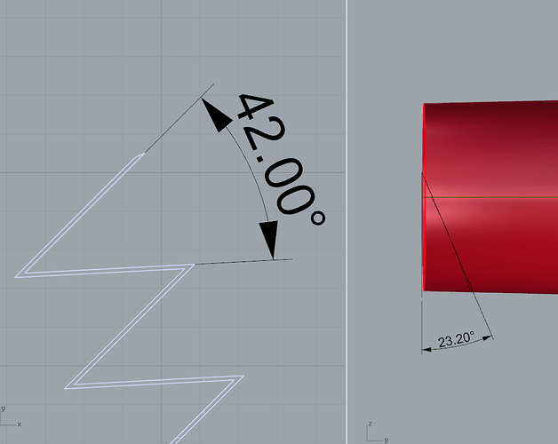

Sorry, I might not be able to help you with this after all. I’m lost as to how the zigzag can be arrayed on the polysrf and follow the path of the helix without being deformed. The flat zigzag form also has an angle measurement of 42 degrees and the helix in relation to the polysrf edge is not a clean angle of 45 when measured from the Right view… I had to draw a couple lines to approximate it but get something more like 23 degrees.

The 42deg angle is what I wanted and the 23.20deg is something that I would have to change…
