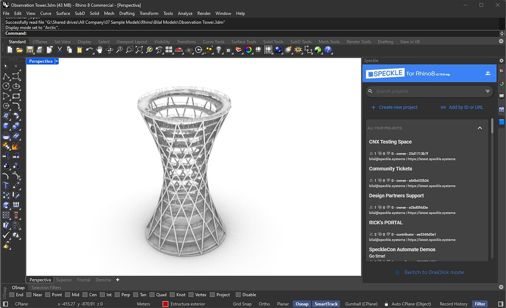

We’re excited to announce that Rhino 8 connector is available with the latest 2.19.0-wip release. It took a little longer than expected due to some breaking changes with Rhino 8, but we’re glad it’s finally here! This wip release is for community testing :partying_face:. If you’re not feeling particularly adventurous, just stick to the stable 2.17 version for now to avoid any interruptions to your ongoing projects.
The official release for Rhino 8 connector will be available with the stable 2.19 release.
How to install it?
To install 2.19.0-wip release for the Rhino Connector:
  1. Inside the “Rhino Connector” page, switch to the “Versions” tab.
  2. Toggle on the “Show Pre-releases” option at the top.
  3. From this list, select the 2.19.0-wip release.
  4. Click on the “Install” button next to it.
Manager_wgAviCea2Q
The good news is that the latest release of Rhino 8 no longer requires the compatibility mode manual install hack workaround. So, please make sure you revert those changes:
  1. Run SetDotNetRuntime command.
  2. Switch it to Default.
Once you do these changes, you’ll be ready to use our connector inside Rhino 8!
What are the new features in this release?
Right now, this early release has the principal new feature of supporting Rhino 8 (+GH) :smiley:
