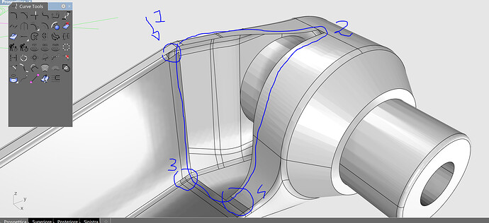

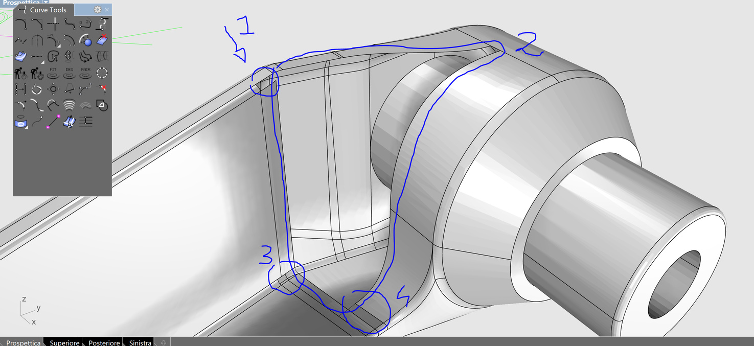

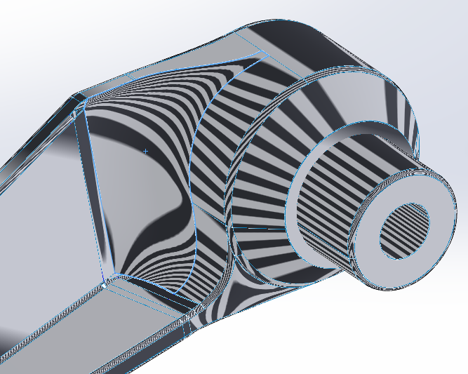

For the first surface, we randomly select 7 edges with different G0/G1 settings as shown in the image below. Donât know your design intention.
The other two are not typical freeform surfaces. For that type of âruledâ surfaces, e.g., âSweep 1 Railâ, usersâ design intention is to sweep the profile along a rail (minimizing the profile change, not minimizing the energy or changing the profile). While XNurbs is a superior solution for freeform surfaces, it may not be appropriate for that type of surfaces. However, we use XNurbs to generate a surface.

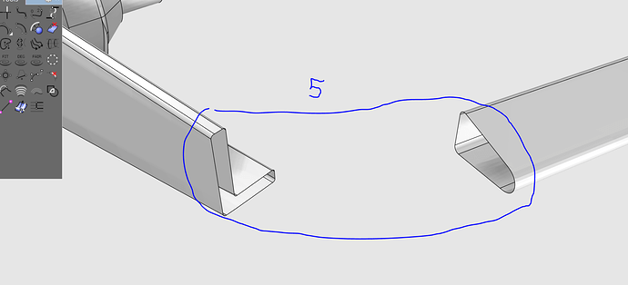

For your 5, the existing boundaries has a maximum edge normal deviation of > 15 degrees. XNurbs considers the input is unacceptable (15 degrees is the max normal deviation allowed.) You should fix the model problem first.
I think we are not talking about the same thing. In my understanding, and seeing your indeed impressive plugin as an improved way of âpatchingâ surfaces together, your approach seems to base on a process similar to mesh relaxation. That, in my understanding, would explain the approach of minimizing energy and acceleration, since this is the consequence of relaxation.
What I was trying to say is, that a relaxation is not necessary what a designer wants. Usually a designer should never come to this âundefinedâ situation seen in the pictures posted by @giorgiapeci
A good design practice would be closing the main surface positional and then thinking about how to blend in between. Without a well defined âtheoryâ, it is unclear on how a blend should look like. It really speaks for your plugin that it produces an acceptable result in this situation. The question is just: Is this sufficient? I personally would not close these situations like this. Looks way to arbitrary and undefined. Itâs not your (plugins) fault, maybe there is no working theory in behind. But I just want to show you that closing holes in a model based on minimal energy isnât the holy grail of Surface Modelling. There are for sure many situations where your plugin will be useful, but I personally still see the trade-off between algorithmic assistance and explicit design control.

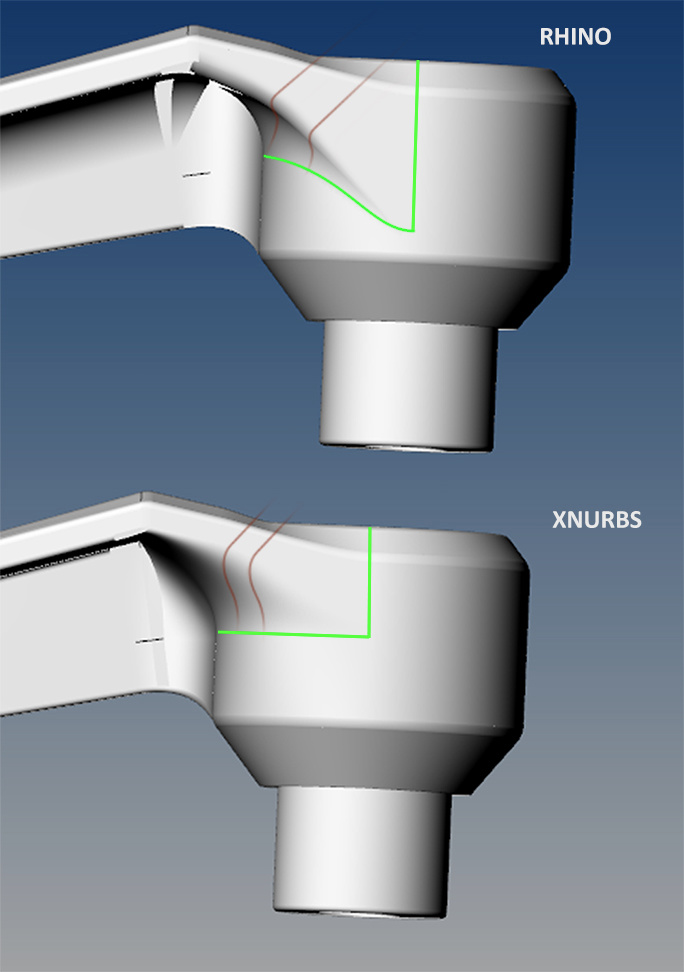

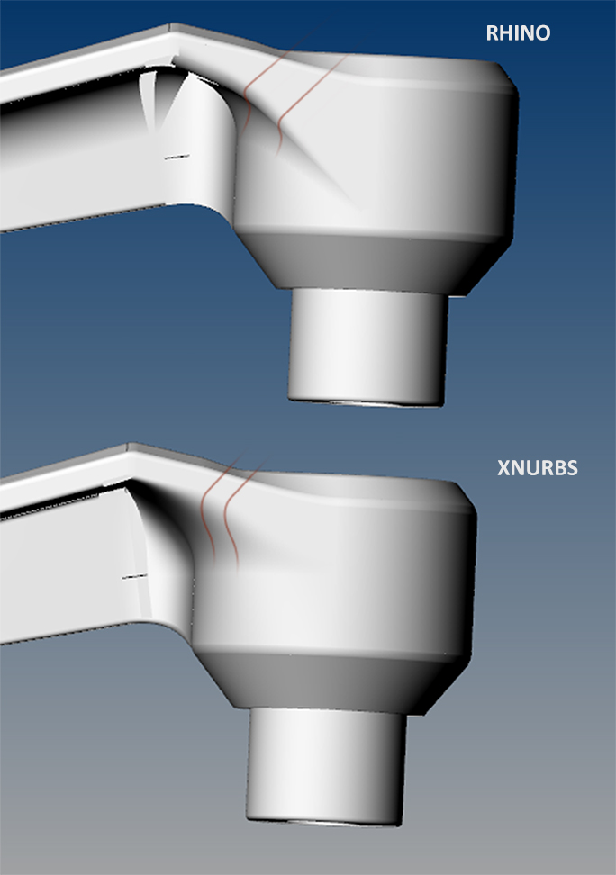

HI Vladimir, are those two examples using the same input boundaries? this is what it looks like to meâŚ
Same input surfaces, extension until edge and filletsrf with slight edit.
itâs G1 on the lower tangent because itâs not the point.
I would say that you could work these constraints (where the surfaces end) with xnurbs as well to get the desired result, but we wonât really know until we test it.
Also just cleaning up some of the input surfaces would make both results much better, no doubt.
Thank you for seeing how you can solve the problem, the file was done incorrectly, to see how the program behaved.

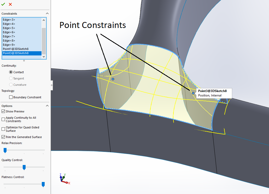

Blending3Surf.3dm (215.1 KB)Multiblend3Srf.stp (107.2 KB)
Adding One usual solution I do, but making curves and dealing with naked edges are
sometime too time consuming. So awaiting any good quick tool out there.
Also the surface is squished a bit due to the guiding curves I madeâŚ
Blending3Surf._oneSolution3dm.3dm (400.8 KB)
Here is the surface generated by XNurbs Multiblend3Srf.STEP (219.6 KB)

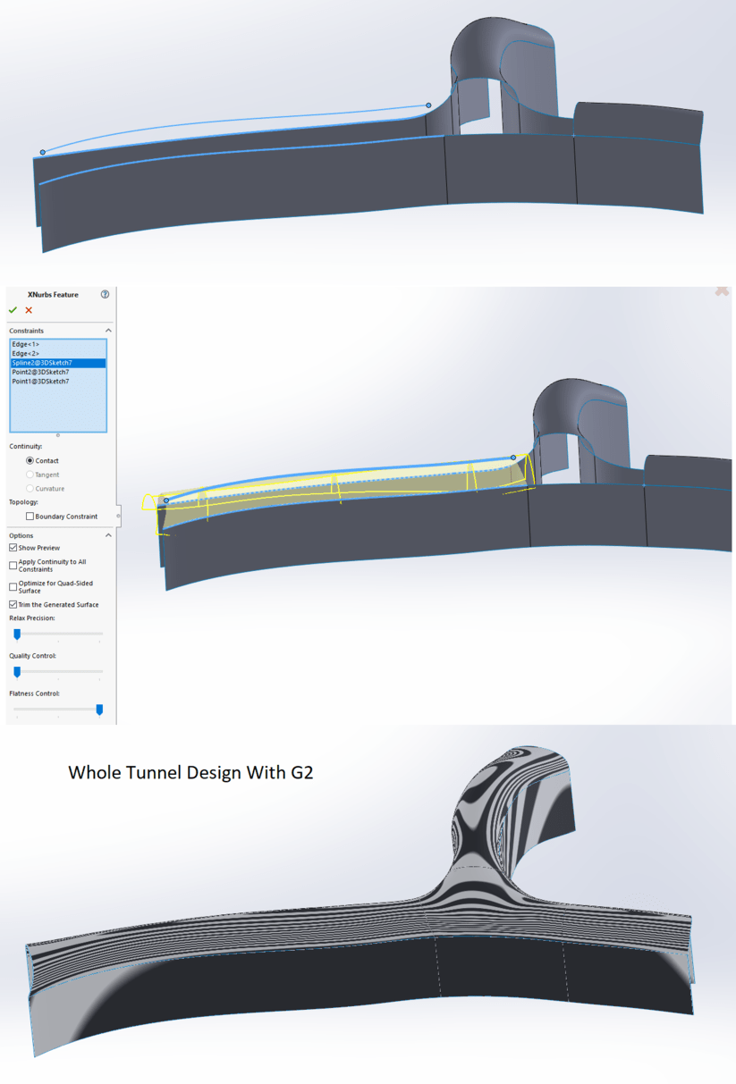

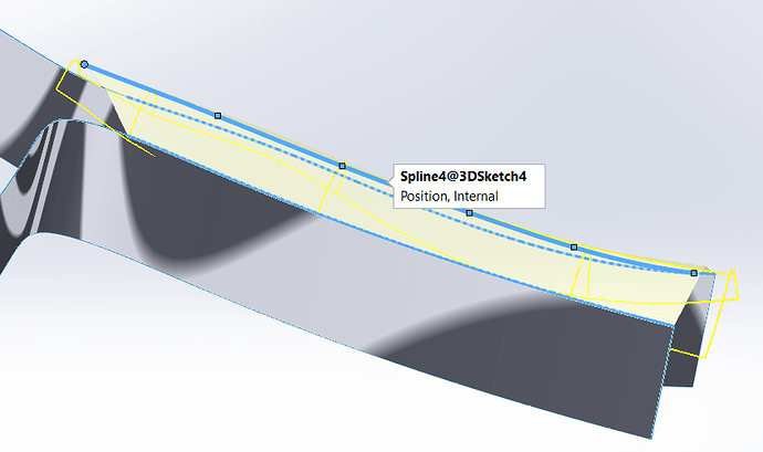

and the screenshots (To show how to control the internal shape, a guide curve in added)
Could you tell me how you designed the existing tunnels - the shapes are not ânaturalâ? The following shows you how to design the tunnels with XNurbs (all G2 continuity. You can use internal curves to control the shape.)
Multiblend.STEP (70.0 KB)

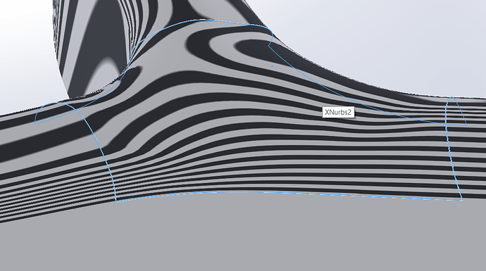

Last week, we also released a new SolidWorks version, and we tested your model with it â it produces a better result for your Multiblend. (That version significantly improves the achieved tangent deviation, so does the Rhino plugin.)

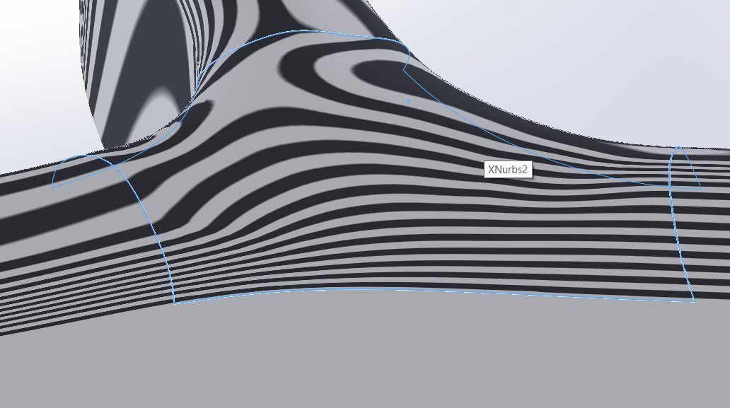

If you redesign the whole tunnel using XNurbs, you can easily get G2 (see the attached screenshots and model. XNurbs replaces sweeps.). (You could get better surfaces if you would use better curves and layout.)
Multiblend.STEP (333.5 KB)
You can add more internal constraints to control the shape generated, e.g., points, curves, point cloud, curve networks⌠(The inner guiding points/curves donât need to be perfect or precise, as XNurbs will automatically optimize and âcorrectâ the guiding points/curves. So you can just draw the inner points/curves on the fly.) The above example show the use of a guiding curve. Of course, you can use any constraints, e.g., a curve network etc. The following show the use of internal points.
