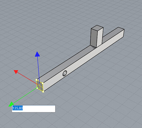

It would be great to have numeric complement button when using gumball.
It happens to me very often that I need to grow this side 135,80 and then I want to enlarge other side also 135,80. But gumball is wrong way. I have to write -135,80. Because gumball remember the last number, it would be great to have “flip” to change positive number to negative, and negative to positive, without you have to click to the exact location and go to keyboard…
kuva
Yes there is scale and symmetry and what ever. Or is there some key allready?
But I wish in the future there would be flip button.
Thanks :slight_smile:
It might not be exactly your problem but in some situations you can orient the Gumball to the object instead of C-Plane. I agree a quick way to invert the transformation would be great.

If you change the Gumball alignment from “CPlane” to “Object”, the arrow will point in the “out” direction on both faces.
