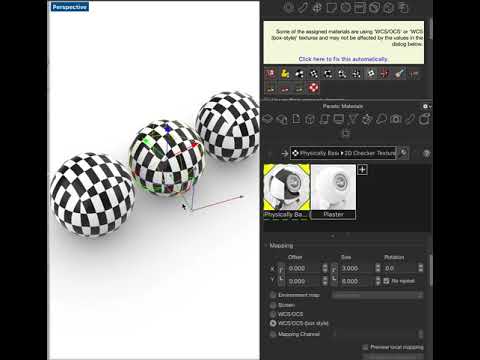

Besides all the issues mentioned above we also have a really bad limitation with Rhino material mapping. We really need to have per-material mapping to have consistency and accuracy of real world material looks. This is what we use in both Octane and Vray in Rhino and Modo.
Please take a look at this video from @IgorK explaining teh limitation we have in Rhino right now:
Do you have a workaround suggestion for this at the moment? And is this something you can address with new features for materials workflows?
Thx,
Gustavo
Looks like Octane isn’t honouring the box mapping applied. It is true that the box mapping is transformed along with the object. If it is box mapping that stays the same always you should use WCS Box instead. Then you can control the texture mapping inside the material.
Apply an OCS mapping for orientation control per object, without further touching the material. That way the WCS (world coordinate system) feature (moving object has texture stay in world coordinate system - gives sliding effect) becomes an OCS (object coordinate system) feature. The texture size will stay the same for all objects it is applied to, but now you can also freely move around the object, transform it as you will without losing orientation to the object.
Here is a short clip
