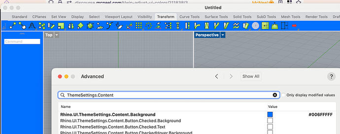

If I look under Advanced and filter for ‘color’ I see this:
The colors show a color swatch of the current setting and a hex value for each.
If I filter for ‘theme’ however, I see this:
No color swatches to show what the current setting is and no hex… Double clicking on a swatch only shows me this:
They’re all #000000 (black - even though the swatch shows white)
:thinking:

The 150(?) colors are mostly computed colors based on a more limited (but still big) color set. There is currently no access to these colors directly; overriding one of the theme colors will just override one of the computed colors.
