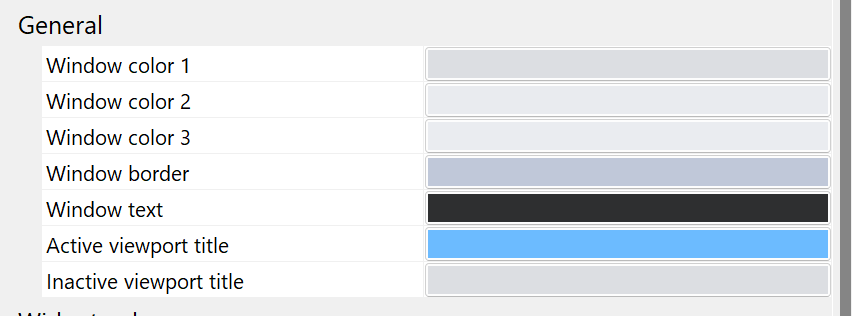

Most of the UI colors are under the “General” section:
However, some of this stuff is still not ‘granular’ enough to be really good (IMO), and on top of that there is no real explanation of what these colors apply to - the Help topic mentions their existence but does not explain what parts they apply to.

General>Window Color 1 = UiPaintColors.NormalStart
General>Window Color 2 = UiPaintColors.NormalEnd
General>Window Color 3 = UiPaintColors.HotStart

General>Window Color 2 = UiPaintColors.NormalEnd controls not only the “end” color of the toolbar icons (if you want a “gradient” look), but also the dialog backgrounds on many of the panels. These really need to be separated IMO.
