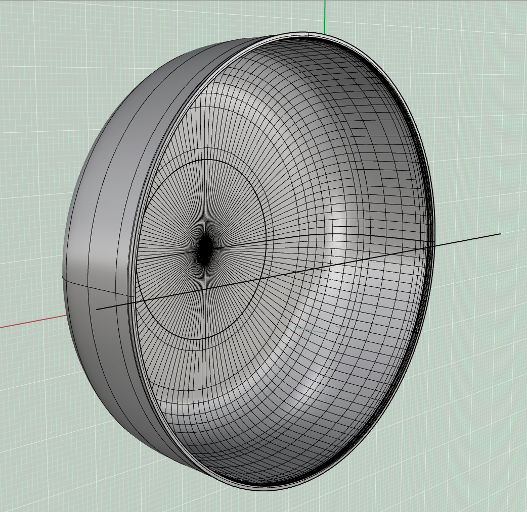

There seems to be quite a few modeling processes that require some kind of fixing before they actually do what’s desired. There is way to much effort required to correct the work that’s generated. It’s always in the end attributed to user error, but one has to wonder if rhino is about facilitating design, or testing one’s ability to obsess over techincal issues.
For example the shell command seldom produces a solid object but leaves behind heavy surfaces that require further work and even then as in this vid there’s still some faults to fix. Isn’t the idea of a shell command suppossed to make designing more efficient? In this case it makes design a rather irritatting task of compensating what the application can’t seem to do.
http://www.screencast.com/t/THHrh6G7LT
And is it really necessary to generate some many iso curves on the interior? The same mess happens when a perfectly clean curve is offset.
The additional control is required to maintain the tolerance you specified.
What is your current absolute modeling tolerance?
If you want the offset surface to have the same control structure as the original, try the Loose command line option.
The Rail Sweeps have a “Simple” option that does a very similar thing too.
You could also determine your wall thickness and use the Scale1D command on your outer curve set to create that thickened wall, it usually results in a much cleaner set of surfaces.
Ok, thanks John, I’ll learn this.
Tex.
basically, dispense with the shelling tool and make the interior surface from scaled down curves.
