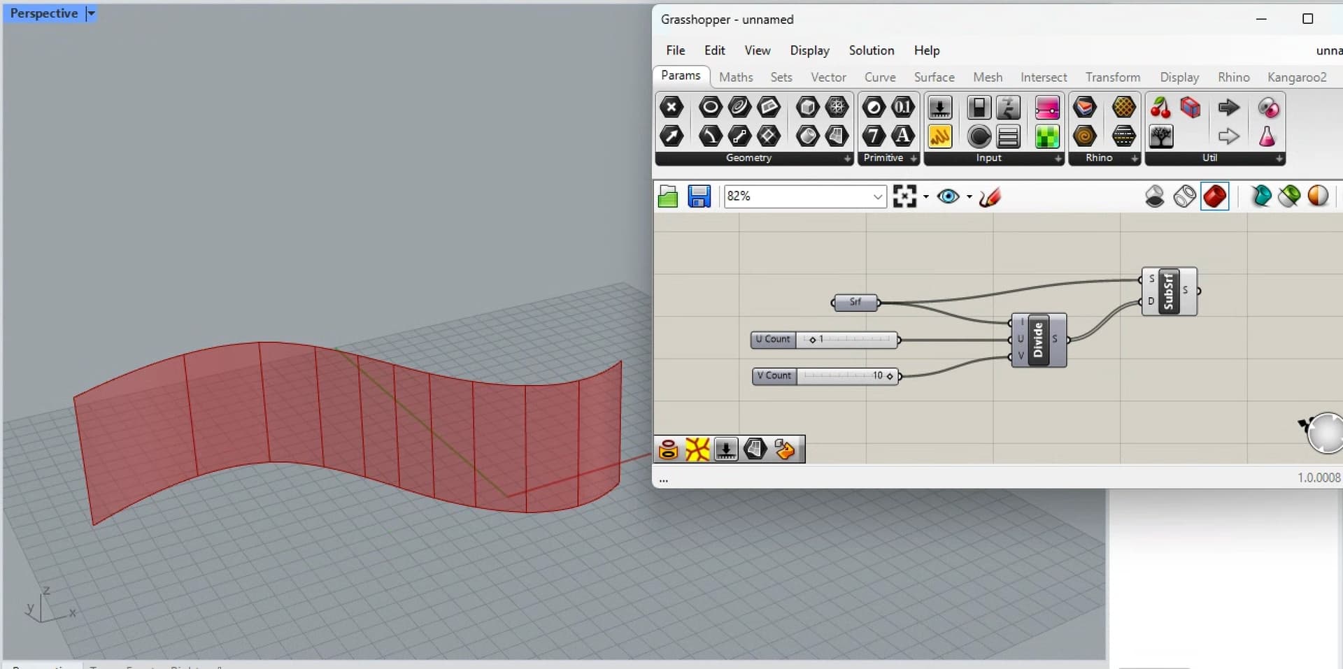

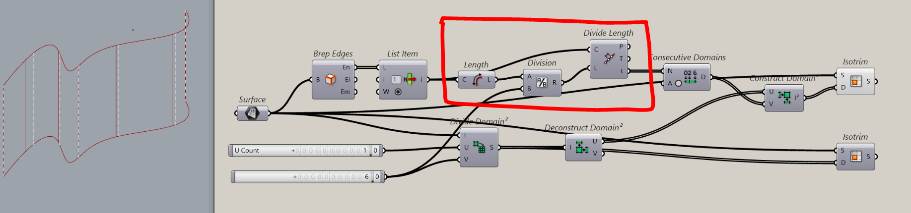

Hi, any thoughts on why that might be the case? Thanks.
right click surface and select ‘reparameterize’
hmm. Just tried but no bueno unfortunately.
UV divisions depend on how a surface is created, they are not guaranteed to be equally spaced.

P.S. You can divide surface edges to create your own divisions.

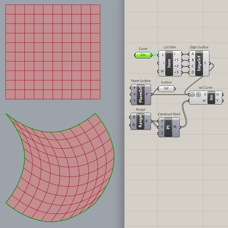

The simplest way I know is to use Iso Curve to see them. Who cares why?

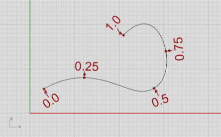

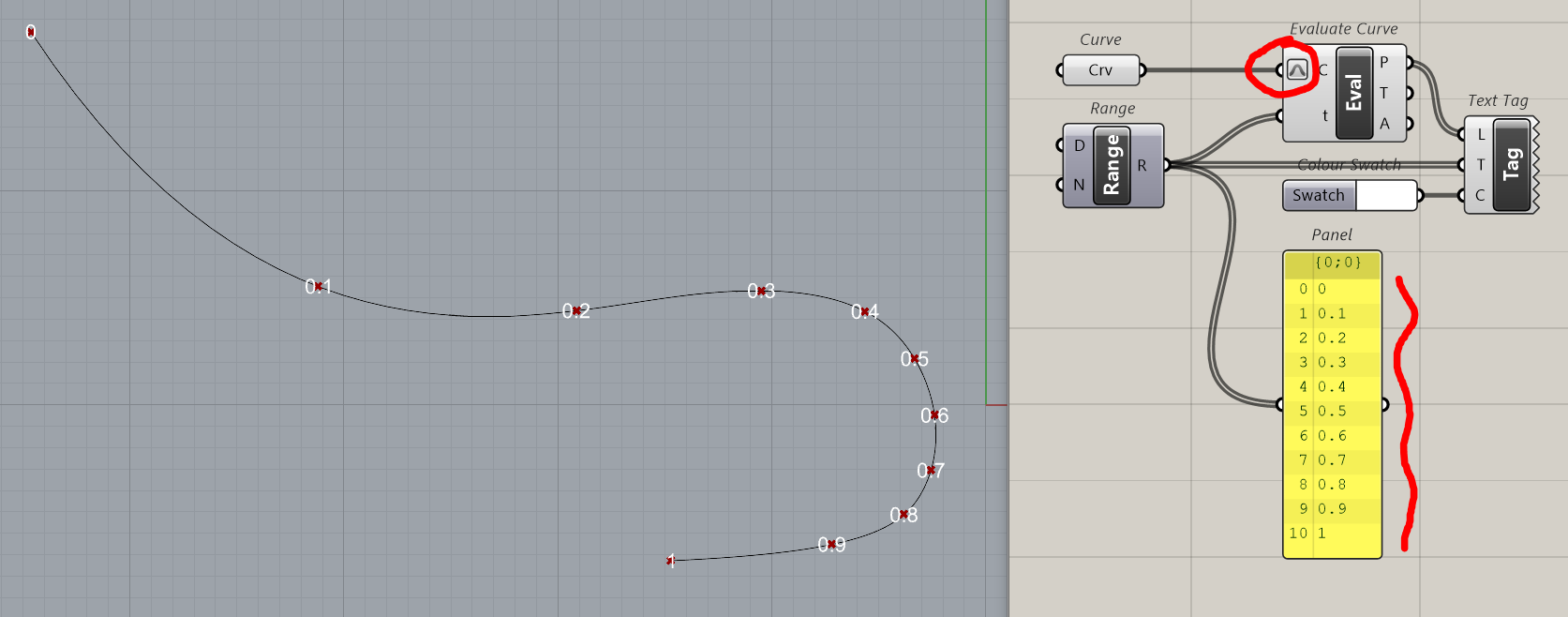

it’s the very same concept of parameters along a nurbs curve: the parameter of the curve will vary its speed depending on curvature, control points location…
for instance here, curve reparametrized with Domain [0,1], parameters Range equally distributed in Domain [0,1], one might expect that the curve is divided into 10 equal-length segments, but because parameters travels at different speeds along the curve, you get a very uneven distribution:
Parameter_speed_in_curve.gh (9.4 KB)

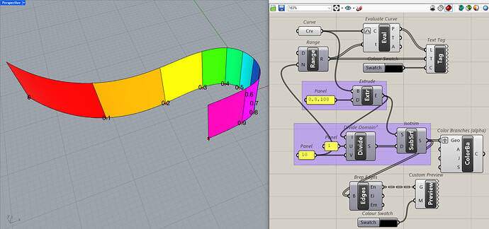

similarly, when that curve becomes a surface through a linear extrusion, if you evaluate the U/V Parameter in the very same previous range you get the exact very same divisions
Parameter_speed_in_curve_2.gh (25.1 KB)
long story short, parameter travels at varying speed along the same nurbs curve, it might be that an increment of t of 0.1 makes you travel 10% of curve length, or 25% of curve length (random numbers I’m spitting here…) depending on where you are on the curve… so you can’t rely on those to make equal divisions

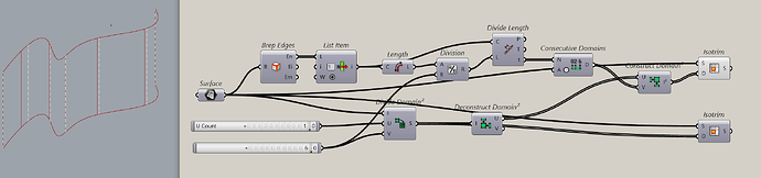

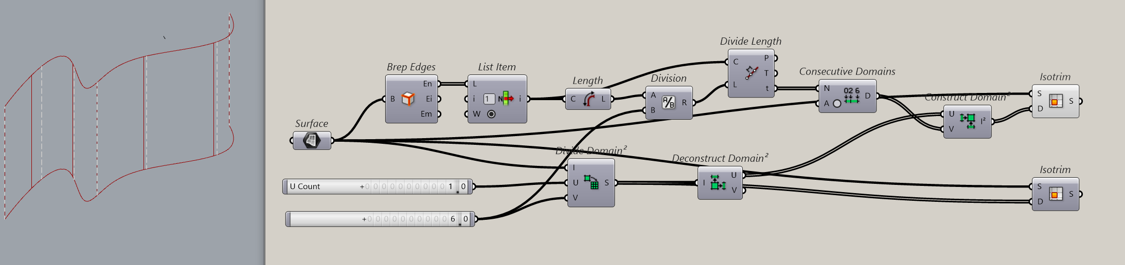

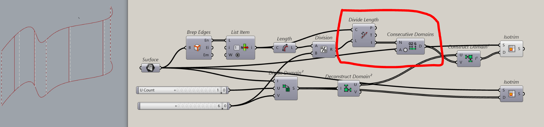

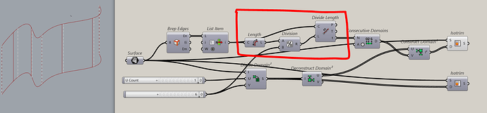

it looks correct because you get the parameters t from the Divide Length:
a bit over-complicated maybe

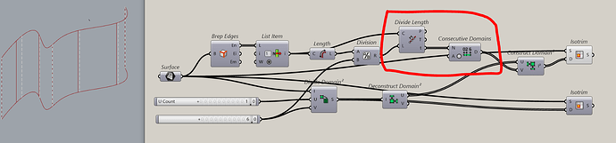

I think you could replace these3 4 components with a single Divide Curve, and just use its t output instead:
Parameter_speed_in_curve_3.gh (9.9 KB)

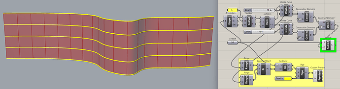

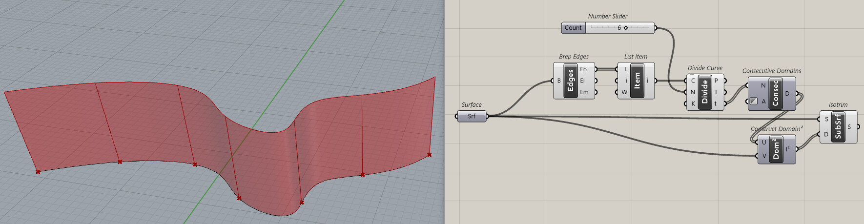

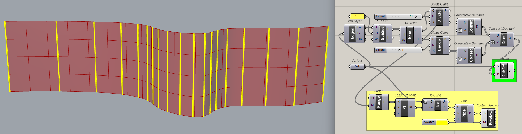

I started with something else in mind but ended up with a 2D version of your code:
srf_div_2025Jun18a.gh (11.3 KB)
The yellow pipes show the uneven isocurves on this surface. I’m not sure why U and V directions appear to be reversed in the two sets of code here? But I typically forge ahead without answers to the why questions. ![]()
srf_div_2025Jun18b.gh (17.0 KB)
