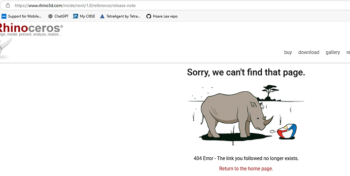

Where can we get older version of Rhino.Inside Revit?
The general release notes are here https://www.rhino3d.com/inside/revit/1.0/reference/release-note.
There is also the github repo if you are so inclined. GitHub - mcneel/rhino.inside-revit: This is the open-source repository for Rhino.Inside®.Revit
thanks,
when I try first link
missed the last letter when i grabbed the link.. Rhino.Inside®.Revit
thanks a lot this is really helpfull…

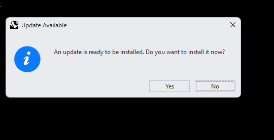

I have two more questions regarding the installer:
  1. When a new Rhino version is installed, is the installer stored locally somewhere on the drive so I coild access it?
  2. Is there a way to download older and specific versions of Rhino?
    For example, I currently need installer:
    Version 8 SR22* (8.22.25201.15001, 2025-07-20)*
    When I run Check Now, I can only download:
    rhino_en-us_8.22.25210.13001.exe
    Since we develop our own plugin, we need better version control and access to specific installers that are known to be compatible.
    Also, when downloading from the Rhino website via
    https://www.rhino3d.com/download/rhino/latest/
    I receive:
    rhino_en-us_8.21.25188.17001.exe,
    which is different from both the one I currently have installed and the one offered via “Check Now.”
  3. Is there an official location where previous Rhino versions can be downloaded?
    This applies to both Rhino and Rhino.Inside.Revit.
Thanks in advance!
Hi Michal,
I believe it downloads in the a temp folder.
The reason you are getting a different release is due to subscribing to the Service Release Candidate.
We don’t have a place to download older versions of Rhino or RiR, we always recommend to be on the latest.
