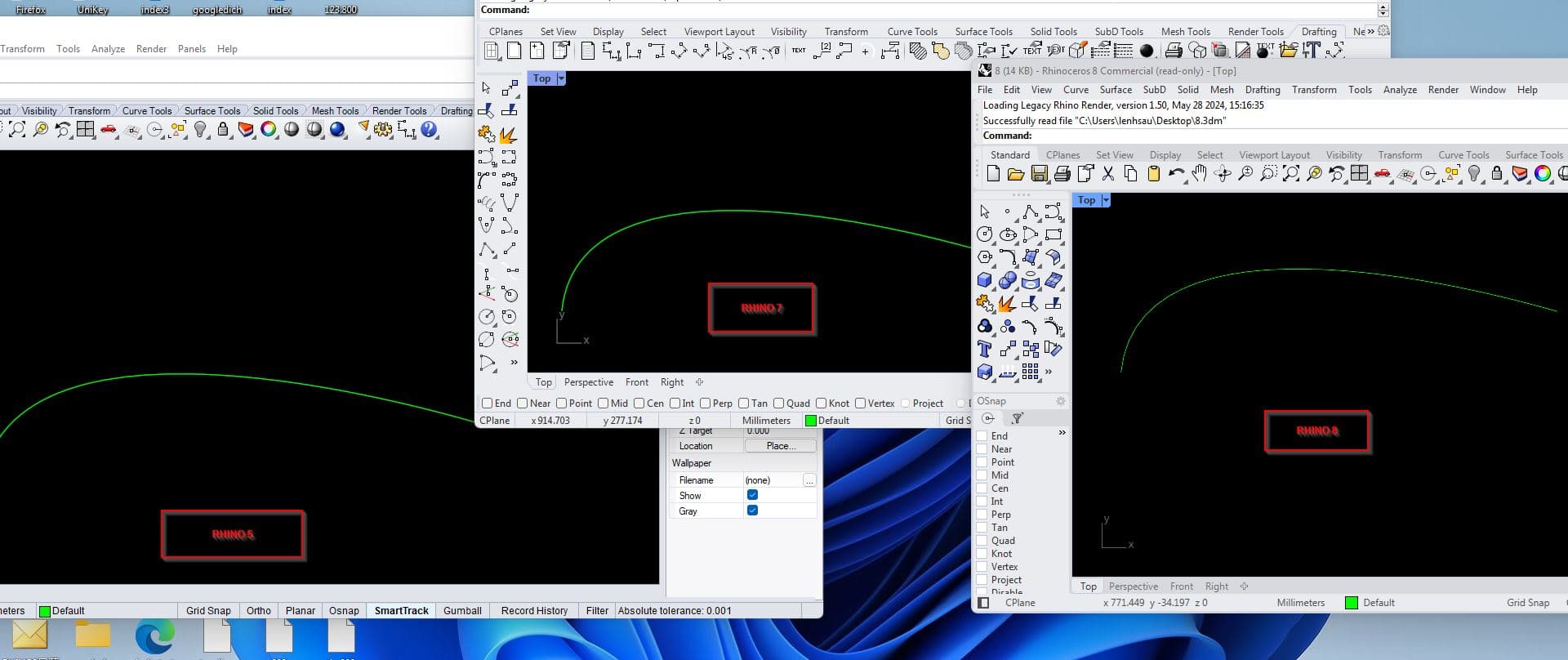

Also, I’m intrigued to see some example screenshots to illustrate how bad the jaggies are when displayed by your graphic card when Rhino is set to its default settings. You say
but on a 1920 x 1080 monitor I find the R8 output better than R5 at default settings. I’ll attach an illustration, but of course it may not display well on your system, particularly while scaled down in this post! This shows R5 and R8 running simultaneously, using default settings, and displaying the same curve:
To my eye R8 is better - do you agree? How does your system compare?
