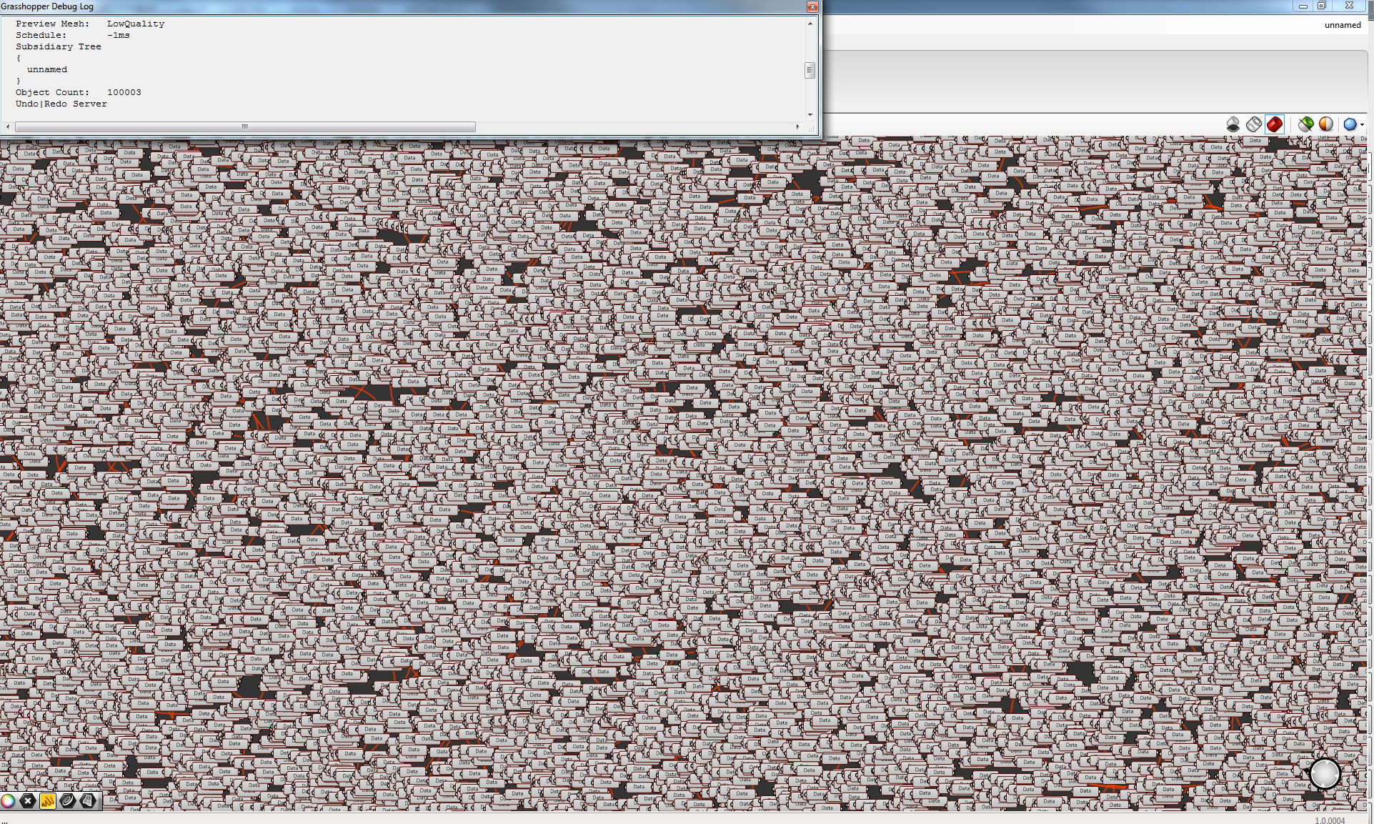

Unfortunate my largest scripts never go beyond 150 due to my personal preference on direct coding. :frowning: So in order to compete here I had to make a useless script
@RIL inspired me :wink:
100003 components :sunglasses:
You must be a more efficient coder, mine is at 5160 (which seems high, only looks like 700 or 800); checking document info, I began working with it in 2013 as something that was just going to be a quick a idea. A tweak here, a tweak there, and it is still evolving.
