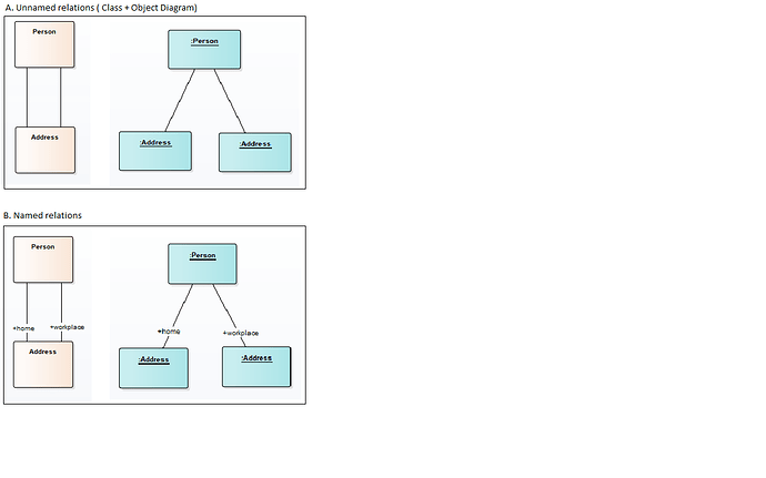

Sometimes even different Types of diagrams are needed. For example, UML diagrams at the lowest level typically consist of #1 Class Diagrams and #2 Object Diagrams . But since the same classes (or objects) are used in different contexts, there’s also need for extended notation for specifying the different uses of a class. See example below:
Fig. 1 Classes to the left, wired instantiated Objects to the right (thus, essentially the same thing, but on different levels of abstraction). A/Top - no distinction between two different use of the same class (similar object), which is an address in this case., B/Bottom - using role names to clarify what use(s) a Class/Object is enroled in :
Rolenames can be useful in both directions. For example, looking from the Address class towards the Person class, the role names could have been employee and resident (multiplicity wasn’t explcitly specified here so singular (single link) implied).
// Rolf

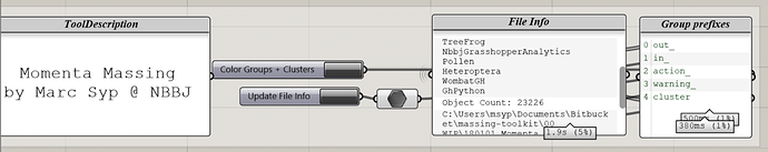

Here is what I’m working on right now. As of today, 23,226 components. This is a full-featured conceptual design application (for architecture) with suppressed Grasshopper, Full Human UI, Onboarding, Two-Way binding with the Rhino interface, many control flow hacks, custom data model, over 500 telepathy namespace entries, clickable meshes, file/data/model exports, etc.
Our GH template autoscans our definitions to update the counts + group colors, and it takes over 3 seconds to get through all the components on the canvas.
I would need 4 monitors just to see it all at the same time (I blew through min zoom a LONG time ago). :smiley: I’m right in the middle of a feature addition and haven’t cleaned up my layout yet, particularly on the right – warning, not for the faint of heart:
