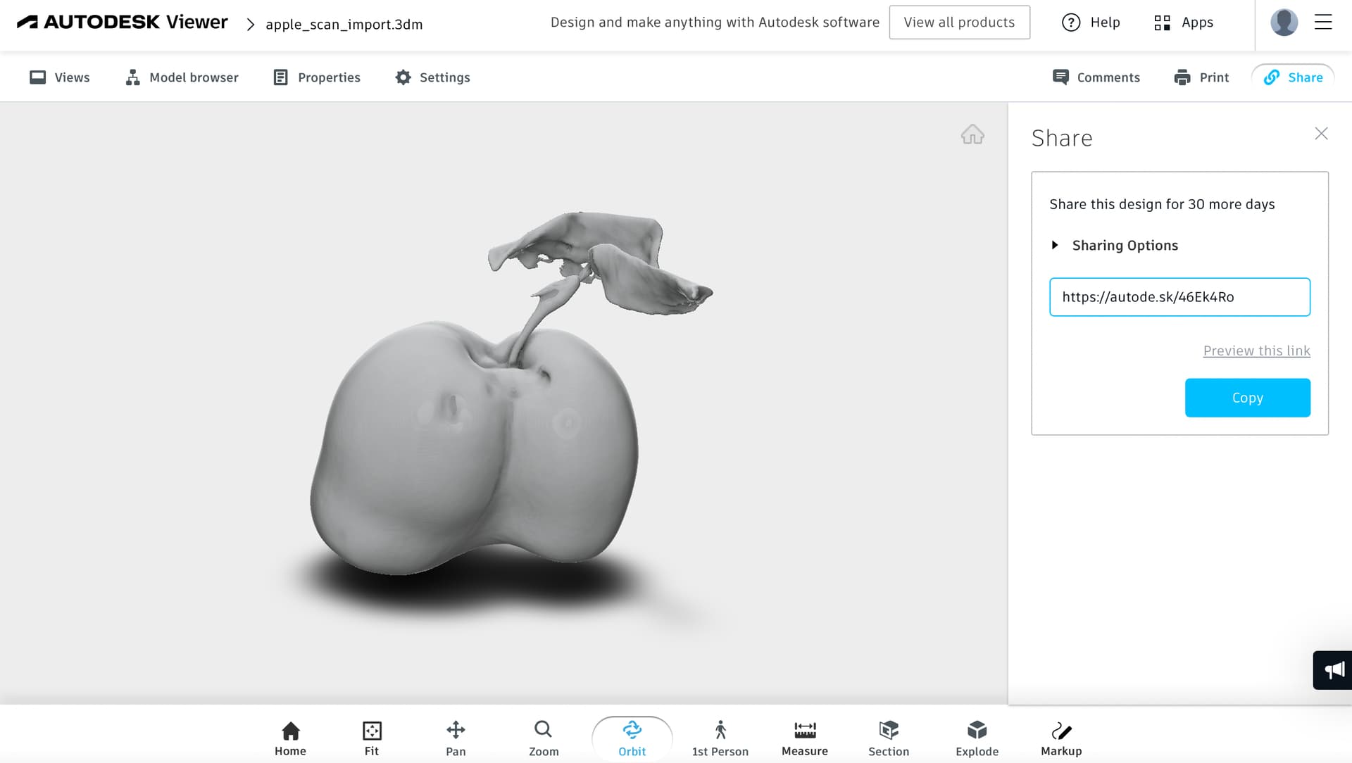

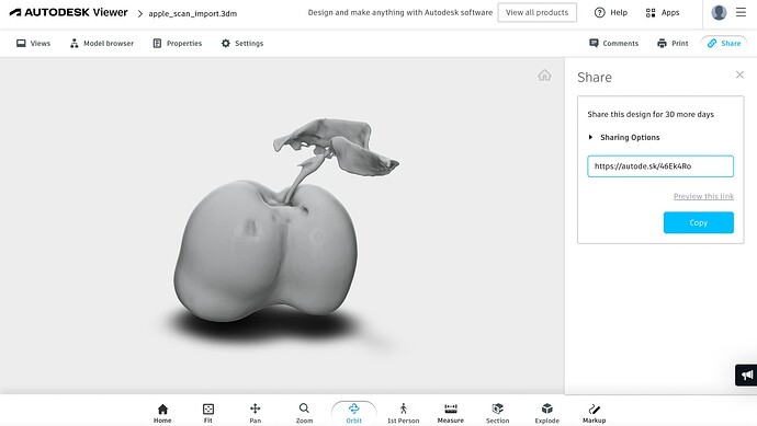

Autodesk has a good online viewer for *.dxf where you can share files. I think it’s much better than 3D pdf which people often can’t view because they’re trying to open with just any app. The viewer can be used with many different file types so conversion might not even be necessary. And all you share is a link which expires after a certain time.
And if you want to stick to 3D pdf, I thought this file format works with meshes doesn’t it? The final question would then be why do you need to convert to meshes at all?
