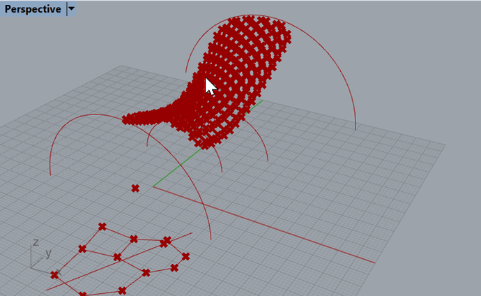

Hi I’m having similar issues as above. Weaverbird is installed. As i read from the _testpackage command. In that window i was also able to update it. See image attached. When i try to open the wb-0.9.0.1-yak-and-mac-install-def (2).gh it gives me a list of unrecognised objects. see attached. Strangely the file opens but there is no weaverbird tab so to see.
Is there a solution to this? thanks
I solved it by updating Rhino…
