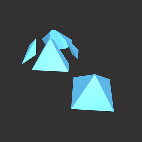

Hello, I’ve been playing with voronoi and an expand script on different volumes. Until now I have had no issues with the volume I am defining, but when I try to use this pyramid script to define the volume for the voronoi, it comes out a rectangle. You can see the defined pyramid, but the expanding voronoi ends up just being a rectangle next to it instead of the pyramid itself.

Thank you for your reply. I tried what you suggested, but it did not change the outcome. I’ve uploaded an image of what i get. from this script. The pyramid at the bottom is the shape I get at the “extrude point” command. The rectangle above is what I get when I plug that pyramid shape into the “populate 3D” command “region” port. Both shapes are visible at the same time and in two differeent locations.

As a general comment: Populate3D always operates inside a box (theoretically in this case the bounding box of the pyramid). You need some culling of the points outside the pyramid or Boolean Intersection between the voronoi cells and the pyramid.

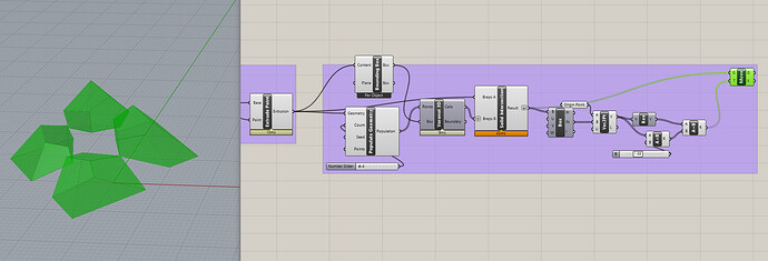

instead of populate3d use populateGeometry → pass those to voronoi3d
the voronoi will always create cells in box, so use the bounding box of your pyramid
to get the correct cell shapes, create a solid intersection with the pramid
and you’re done

Is this what you are after?
expand_pyramid voronoi1.gh (20.9 KB)
Thank you! I was just looking at it in GH. So, anytime the shape I want to “break apart” isn’t a box, I want to use populate geometry?
in your specific case, pretty much yes. In reality with PopulateGeometry you get points inside the shape.
