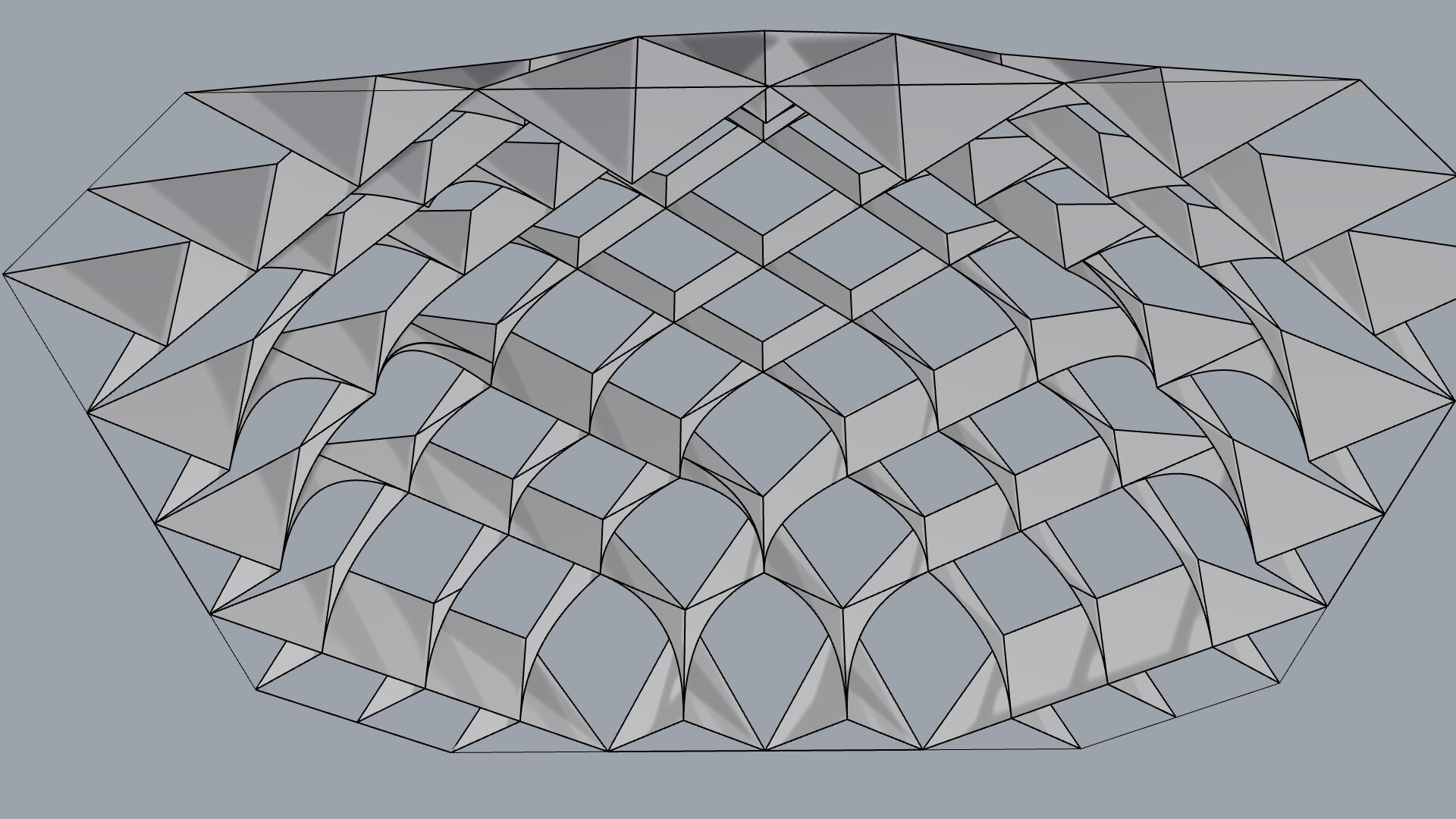

Volumerization a set of closed curves
I have worked on the following definition in order to volumetric those closed geometries, but unfortunately, I couldn’t generalize it to work on other tetrahedrons as well. Is there any idea that we can apply multiple curves?
5-30-2022.gh (23.1 KB)
Please illustrate the expected result. Either with a sketch or with a Rhino model.
Thanks for your support Martin. Here is the expected result
30-5-2022.3dm (1.5 MB)

I have found a solution to this problem that I have had and I wanted to share it because it may help somebody else as well. I also want to thank @martinsiegrist for his consideration of this problem.
6-4-2022.gh (74.4 KB)
