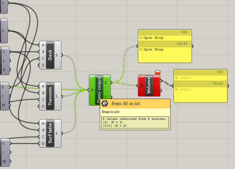

I generate parametrics hulls immersed bodies from trimming hull by water surface, then close the volume.
I try to calculate its volume but the function does not work an i have no result . Did somebody have this kand if issue ?

I can’t calculate the volumes of hull constituted by several joigned surfaces. Meanwhile when i bake it Rhino can do it and the surface analysis on Rhino shows no trouble in surfaces joigning.

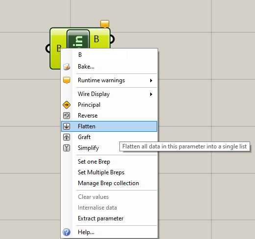

the problem here is that the surfaces are not joined in a closed solid because they are on different branches

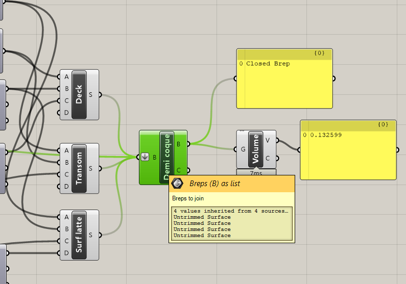

by flattening the JoinSurf input:
Thank you, what is the solution then to solve it ?
I mean hw to flatten ?
Thank you
right click on the input B and chose flatten
the arrow pointing down will indicate a flattened data tree
Nice it works well. Last questions, i try to find the equivalent to mathlab “sink” that is a display in GH no tin the Rhino windows that will DISPLAY me the volume calculated. Is it exists ? I can’t find it…
