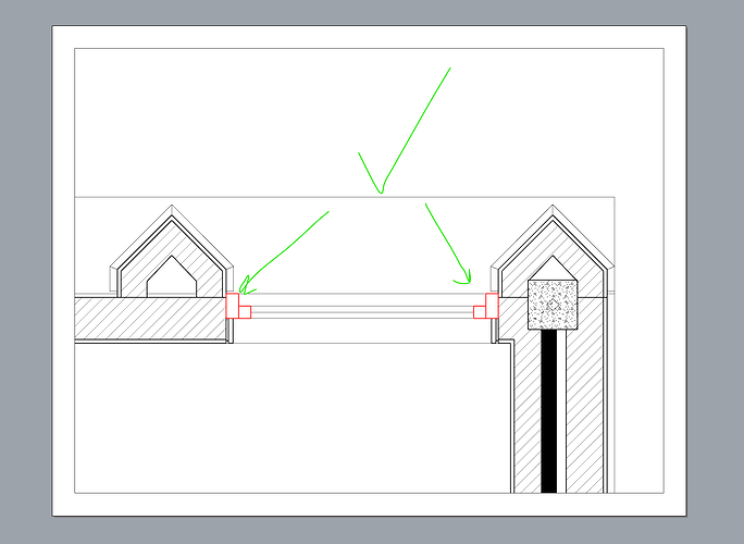

It seems VA or Rhino are drawing the wrong lines to be on top in a sectioned plan?
Meaning the clipped geometry lines are being drawn below the projected ones, at least that is my understanding.
The problem at hand is the cut line of my mullions on my awning windows that are behind their gray lines (projected).
Any thoughts on this?

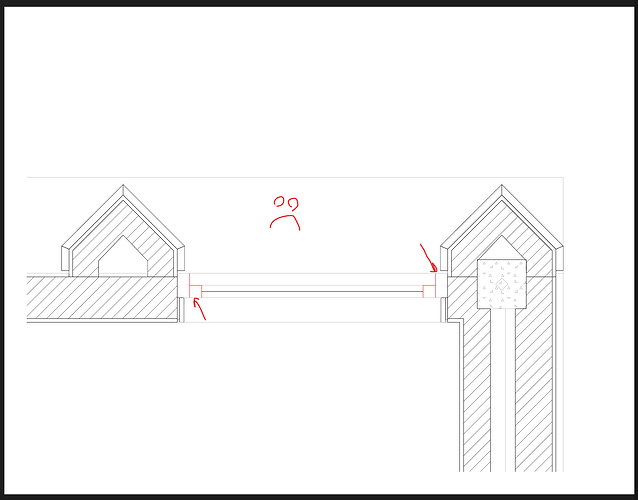

PrintDisplay “On” on layout shows correctly
PDF print, Vector at 600dpi results in confusing lines and draw orders. this happens for both plans and sections on my test. :expressionless_face:
Sharing the 3D model where you can see the problem.
Let me know if Im missing something here…

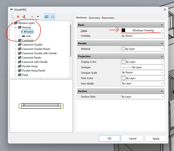

Also, small comment. every time I paste a VA object to different file. if that file has the VA Standard layers inside a sub layer, and then object gets pasted into another empty va file, it just resets all the VA object attributes and moves them to the standard template VA layers, I have never heard of copying an object into another file and it not sticking to the same layer (the correct layer gets copied but its empty)?

Hi Lourenço,
Thanks for the detailed explanation and for sharing the file.
Regarding the first issue with the draw order in sectioned plans, you’re right — this seems to be a bug. I’ll report it to our bug tracker, and I’ll keep you updated once it’s been fixed.

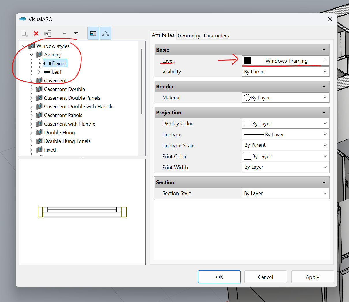

Regarding the second issue:
To illustrate the problem, imagine the VA layers have been reorganized—say, grouped under a single layer named “VisualARQ.” If you copy and paste a window (along with the wall it’s attached to) into a new VA template file—making sure units match—you’ll notice the red cut line reverts to the default black.
On inspection, the awning window appears to lose all its custom parameters, including layer assignments for each geometry and its “Section Style.”
In the attached image, you can see how both the layer and section style revert from their previously set values to whatever the VA system uses by default.

Hi @lourencovp,
When you copy an object from one file to another, if the style already exists, the layer attributes and style attributes in the target file prevail.
This is the expected behavior. And it works also this way with Rhino geometry.
If this is not working for you, can you indicate in the model you attached, which object are you copy and pasting, and also provide the target file were you are pasting it? (Or prepare two files that we can use to reproduce this error). That way we can try to reproduce any errors.
