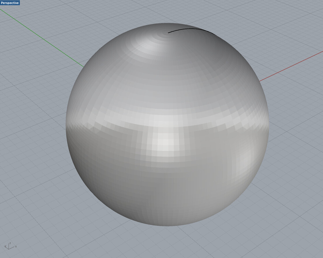

Hi I have somehow done something to my viewport shade settings. because now its all low polygon. And i can’t figure out what has changed.
Its the same computer and Rhino version that worked fine a cupel of days ago. so im pretty sure its a setting thing.

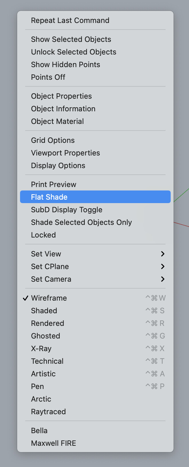

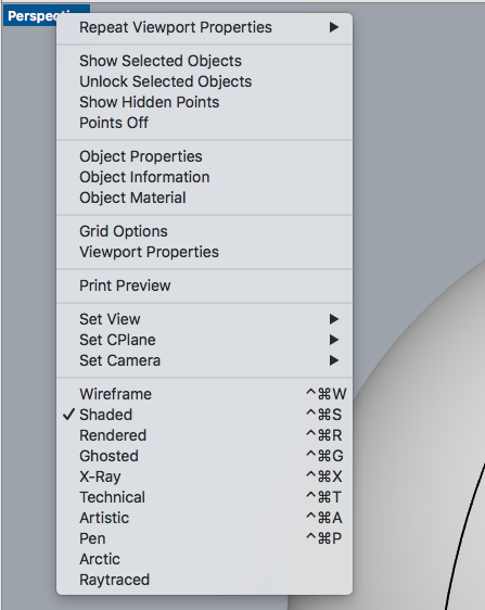

Well, under General settings in the right sidebar, you are setting the characteristics for the display mode. However, that can be overridden by a local viewport display mode - if you right click on the blue “Perspective” viewport title in the upper left, you will see a menu drop down, does it have “FlatShade” checked?
FlatShade is not mentioned in that menu. (can be a Win, Mac difference)
Looks like it… Do you see the same menu if you click on the main (title bar) View menu, or are there more items in it? BTW, what version of MacRhino is this?
interesting, it is mentioned here
Version 6 (6.31.20315.17002, 2020-11-10)
And yes it is in the main menu. Strange why it is removed from the local window, to me it makes sense to have it there.

@Rasmus Try resetting your Shaded display mode in Preferences > Display Modes to the default settings. Does that help? What you’ve shown is indeed a flat shaded render mesh of a NURBS sphere.
Hi Brian thanks for the suggestion. it dit reset FlatShade but not fix the problem completly.
