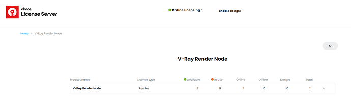

I’ve been using V-Ray as my main render engine for a few months now. Everything’s been fine until today, when this showed up
I usually just manually start my Chaos License Server, and login through my credentials, and this shows up in my default browser:
However, when I restart my Rhino, the “Verify your V-Ray for Rhino License” still pops up. When I click on “Sign in” nothing happens.

Hi, did you ever find a solution for this? I’m currently experiencing the same issue.
Yes! Reinstalling the Chaos License Server, and logging in with my credentials did the trick. If it doesn’t work for you, the customer support at Chaos is usually quick to respond.
When I reinstalled Chaos License Server, nothing changed. Then I unistalled again, RESTARTED PC, installed Chaos License Server and finally it works.

typically CLS installs some shortcuts in the program group folder. If for some reason the licensing service does not automatically start (say Firewall, Antivirus, networking issues, … ) you can start it manually.
