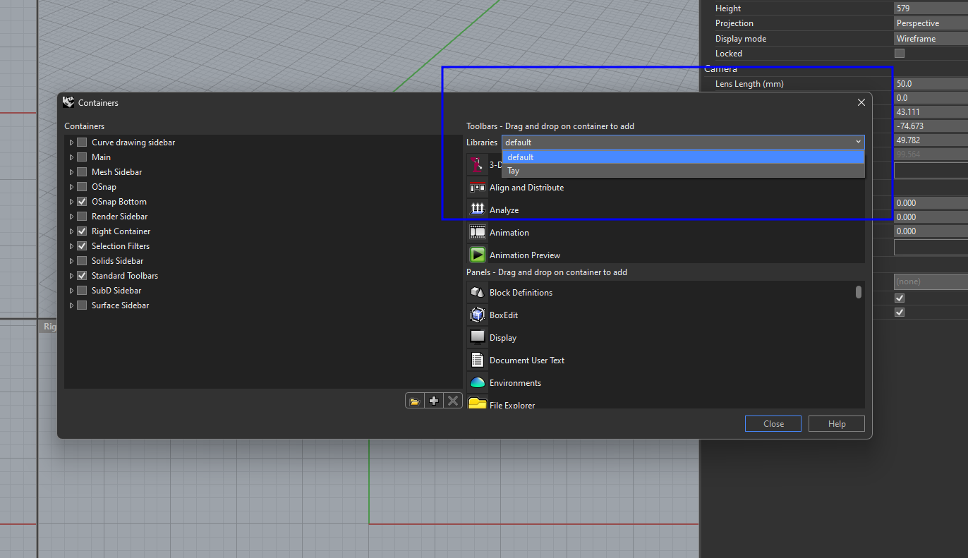

The new UI uses a new thing called Eto. Which is a good way of building UI elements in the modern day. Its essential feature that can be adapt to any dpi scaling with higher resolution monitors.
The new UI is built by containers (UI boxes) each container can hold toolbars , and Panels.
So toolbars will remain as tool-bars while containers are the “containers” that holds them.
This also helps you creating customizable UIs that you can change, revert to and share it with other people.

That are still the same RUI files

Where’s the import RUI option?
I found toolbars but don’t see toolbars… lol
hmmm this is weird… “open rui file” hmm :thinking: :thought_balloon:
You link them through here,
then in the containers it will show up as a new toolbar group
:exploding_head: where’d you get that dialogue though?
type “containers”

secret button somewhere:
ahhhh I see it now :star_struck:

the good thing, containers can be saved seperately as rhw files and you can use them to switch your window layout based on a specific task or a resolution
I made one for my 1440p monitor, I will make another one for extra wide monitor as well.

assuming you want to add a bigger monitor to your 15" laptop, you can have 2 UI configurations, so you can use one when the monitor is detached and another configuration when the monitor attached.
